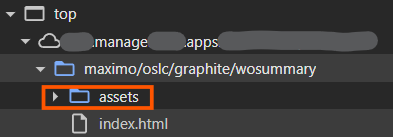

    Also, the loaded sources structure is different:
    Cloned app:
    A screenshot of a computer
AI-generated content may be incorrect.Original app:
