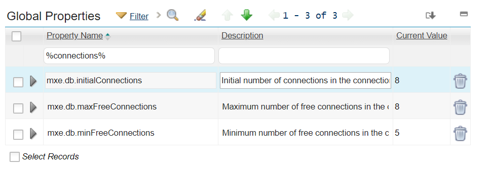

Maximo has its own connection pooling and it clears the session from MAXSESSION table but can't clear them from V$SESSION table which is managed by Oracle. There are a set of properties related to connection pooling which you can find in System Properties application -

https://www.ibm.com/support/pages/why-are-my-oracle-sessions-inactiveYou should revisit automation scripts if any available, or reports to ensure that you are not leaving DB connection open. Also, check the oracle parameters on DB is set per best practices guidelines from IBM. These parameters impact Maximo performance and Oracle session management -
