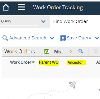

    Hi.
    What about adding new column(s) in to list view in Work Order Tracking application.
    So users could filter workorders by Parent or Ancestor.
