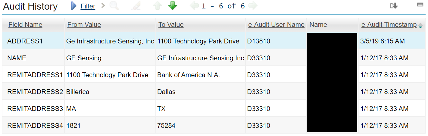

    We implemented a solution a few years back where we created a view to show changes based on specific fields. We were able to show the field name, previous value, new value, changed by, and change date. The view was fairly verbose, so we limited it to a certain number of fields. Here was the result:
    Is something like this what you're asking about?

    Hi Alex,
    Yes this is what I was looking for? Is this an automation script? Or a way to use the a_object table to display ?

    We built a database view against the A_OBJECT table, and then created a relationship from the main object to the view. In this case, it was a view against the A_COMPANIES object.
    The view utilized the LEAD/LAG functions and got quite verbose, but worked since we only targeted about 20 or so fields. It might not work if trying to target many more fields because of how verbose the view SQL is.

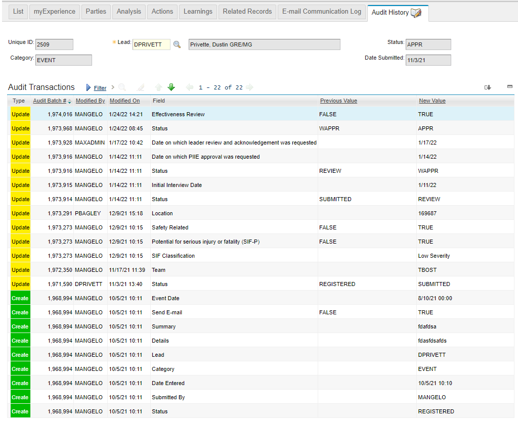

    Hi Megha!
    We have been similarly dissatisfied with the out-of-the-box Maximo auditing, and so have taken a different approach that we think better fulfills the core REQUIREMENTS of auditing and still is w/in the realm of "configuration".  The basic approach looks something like this:
    1) Create a separate "audit" table--we currently have ours as "AUDIT_GRE" but I think I'd probably actually create separate audit tables for larger core tables like WORKORDER.  This audit table has columns for OBJECTNAME, ATTRIBUTENAME,  RECORDKEY, RECORDCLASS, "previous" and "current / changed" value, and so forth...the nice thing about this table is that you get a separate row for each changed field...
    2) On appropriate points for your target objects (e.g. WORKORDER.SAVE), create / update the automation script to include a call such as this:
    from psdi.server import MXServer;
    from psdi.mbo import MboConstants;
    from java.util import HashMap;
    # # # # # DO AUDITING # # # # #
    ## Get values
    record_key = mbo.getString("TICKETID");
    record_type = mbo.getString("CLASS");
    parent = "";
    ## Figure out a friendly description
    vDESC = mbo.getString("DESCRIPTION");
    vDESC = vDESC[:255];
    ctx = HashMap();
    ctx.put("mbo", mbo);
    ctx.put("record_key", record_key);
    ctx.put("record_type", record_type);
    ctx.put("parent", "");
    ctx.put("YORN_format", "FRIENDLY");
    ctx.put("DESC_attribute", "DESCRIPTION");
    ctx.put("description", vDESC);
    service.invokeScript("AUDIT", ctx);
    3) As you can insinuate from #2, you have to have a script to actually DO the auditing...this script actually looks at the database configuration information and only "audits" fields that are flagged as e-audit enabled...I attached the script to this post...
    4) Create a relationship between the Maximo table and the audit table
    5) Expose the audit information (as you see fit) on the screen...example from our system shown here...​
    Embedded audit information in our application screen...
    Hope this helps! :)
