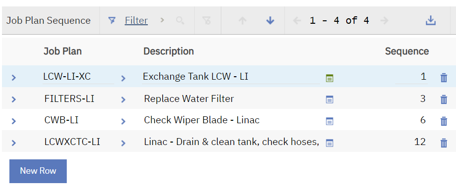

    I think you misunderstood what I meant - and that I have 4 different Job Plans within one WO....
    I know how the frequency works for a PM with only one JP, but for multiple JP's within one WO, I need each of the JP to run independently - so for example if JP #1 has NOT been completed, JP #2, #3 and #4 will all execute and create WO's whether JP #1 has been completed/closed....
    Like in my screenshot below...... if the first JP 'Exchange Tank LCW' is open for say, 6 months..... in the meantime, I want the other JP's to generate work orders regardless:
  • 6.  RE: PM with Job Plans, possible to have each JP not rely on previous to be completed?
    Posted 02-09-2022 12:21

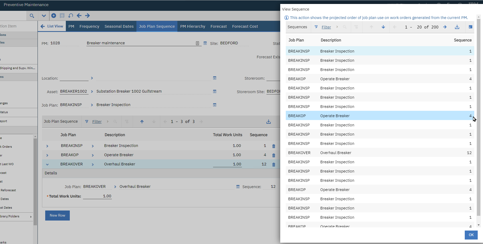

    To make them truly independent, then they will need separate pm's. Take a look at the View Sequence, to see how they will come out, and keep in mind, the frequency on the pm is what drives everything. So, if the frequency on the pm is every 6 months, then the pm will only generate a work order every 6 months.
    Christopher Winston
    Projetech Inc.
  • 7.  RE: PM with Job Plans, possible to have each JP not rely on previous to be completed?
    Posted 02-09-2022 12:37
    Christopher - thanks for this info.... so it sounds like for my needs - I will have a separate PM for each JP, since I need them to run independently from one another. Thanks for clarifying this!
