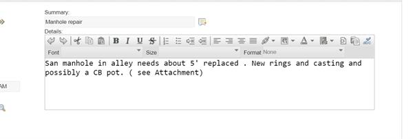

    Below are examples of what it looked like in 7.6.0.8 and what it looks like in 7.6.1.1
    7.6.0.8 work and communication log in work order tracking

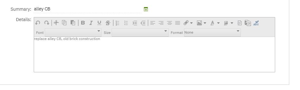

    7.6.1.1 work log in work order tracking
    Work and communication log

    Hi Diane,
    Are you using IOT18 skin, from the screen shot it looked like old skin (Tivoli13 or Tivoli09) ? There  are folders for other skins at "applications\maximo\maximouiweb\webmodule\webclient\skins\" where you may want to try to make similar change to extended.css based on Skin that Maximo is using.
