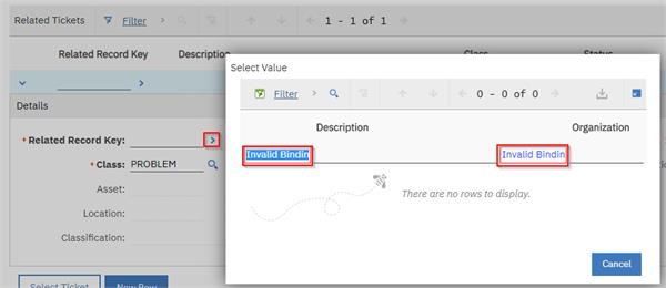

As for potential issues, by overriding the core attribute for RELATEDRECKEY you've broken the ability to relate ticket based objects in some situations. For example, if you go and add a row to the related tickets and try to use the lookup you'll see invalid bindings and no records because it's trying to look at WORKORDER now instead of TICKET. See below of a screenshot. You also wouldn't be able to utilize the Go To SR function without additional changes.
