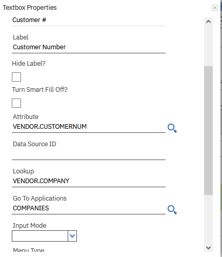

  • 6.  RE: App Designer: add CUSTOMERNUM to Inventory Screen
    Posted 03-07-2022 15:25
    Here's what I have in the Properties for that textbox with lookup.  Not sure if this is right, but it seems like the lookup should point to COMPANIES?

  • 7.  RE: App Designer: add CUSTOMERNUM to Inventory Screen
    Posted 03-07-2022 16:03
    Based on what you've described, this field is free text on a company record, correct? If that's the case, you can't use a lookup on this attribute as it is today and I wouldn't recommend modifying it to support a lookup. Domains, java classes with getList, retrieve list automation scripts, etc. are the critical plumbing that makes lookups possible. Without one of them on your field you can't utilize lookups and it doesn't make sense to add them to an attribute where you aren't restricting the data.
    What you can do is display the VENDOR or MANUFACTURER attribute instead of your VENDOR.CUSTOMERNUM attribute. The VENDOR & MANUFACTURER attributes support a lookup against the company table. I mistakenly typed VENDOR.COMPANY in my earlier reply but you can't use that and wouldn't want to use that from a search performance perspective. These attributes already exist out of the box in the Advanced Search dialog.
    Lookups exist in the LIBRARY.XML or LOOKUPS.XML and are not dot notation based. If you go into Application Designer and choose Export System XML from the Select Action menu you'll be presented the option to export these two system XMLs. The one most relevant to what you want to do out of the box is in the LOOKUPS and the lookup is called COMPANIES (id="COMPANIES"). This is what we display in a lot of places inside of Maximo.
    If you modify this lookup or clone this lookup (copy and paste that lookup and change the IDs to make them unique) and add in your CUSTOMERNUM attribute you'll allow the user to filter for COMPANY records that have the CUSTOMERNUM you want. They then can select them from the dialog to return the COMPANY attribute to the VENDOR/MANUFACTURER field (or anywhere else in Maximo that lookup is referenced) and be able to filter it.

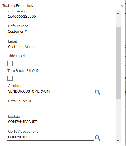

  • 9.  RE: App Designer: add CUSTOMERNUM to Inventory Screen
    Posted 03-08-2022 12:28
    Here is the XML segment that I created - cloned it from the Previous segment.   It uploads just fine in to App Designer with no errors but the functionality doesn't quite work yet.  Below it is the Properties of the Textbook itself (this will be going in the Reorder Details tab of the INVENTORY app)
