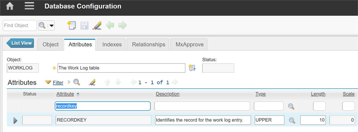

    Step 1: Check Field Lengths
    The WORKLOG table has a field called RECORDKEY that is used to store the key attribute information for the related record. In the case of Work Orders, the WONUM field is stored as the RECORDKEY. In the case of Service Requests, the TICKETID is stored as the RECORDKEY.
    As we are configuring Work Logs for Locations, we need to store the LOCATION field as the RECORDKEY in the WORKLOG table. Before doing so, let's make sure that the field length of the WORKLOG.RECORDKEY is at least as long as the LOCATIONS.LOCATION field, to prevent character length issues down the line.
    1. Log into Maximo as an administrative user
    2. Navigate to the System Configuration > Platform Configuration > Database Configuration application

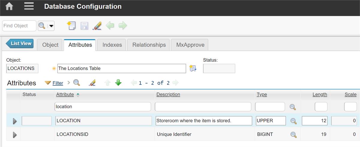

    3. Locate the LOCATIONS object, then navigate to the Attributes tab
    4. Locate the LOCATION attribute, and note its field type and length
    5. Navigate back to the List View, locate the WORKLOG object, then navigate to the Attributes tab
    6. Locate the RECORDKEY attribute, and note its field type and length
    7. Update the Length attribute to be at least as long as the length of the LOCATIONS.LOCATION field, if necessary
    8. Save the record and perform the Database Configuration steps, if necessary

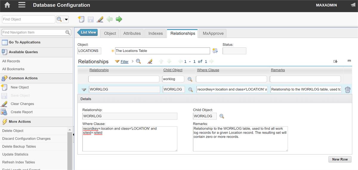

    Step 2: Add New Relationship
    We will need to relate the LOCATIONS table to the WORKLOG table via a relationship in Maximo. This relationship will be used as part of the subsequent configuration to display Work Log entries that are related to a given Location.
    3. Locate the LOCATIONS object, then navigate to the Relationships tab
    4. Click the New Row button:
      1. Name: WORKLOG
      2. Child: WORKLOG
      3. Where Clause: recordkey=:location and class='LOCATION' and siteid=:siteid
      4. Remarks: Relationship to the WORKLOG table, used to find all work log records for a given Location record. The resulting set will contain zero or more records.
    5. Click the Save button

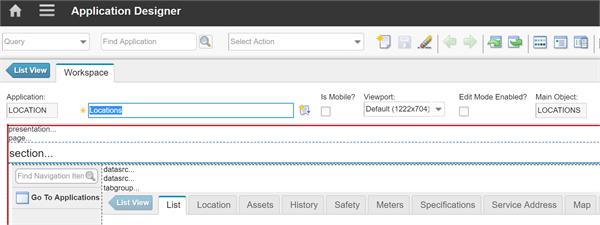

    Step 3: Add Screen Changes
    This is where the fun begins! We need to add the Work Log screen details to our Locations application in Application Designer. The steps below can be simplified by copying and pasting the XML for the new Work Log screen details into the exported Location XML file, and importing the resulting file back. If you run into trouble, watch our YouTube video on how to perform these steps.
    2. Navigate to the System Configuration > Platform Configuration > Application Designer application
    3. Locate the LOCATION application, then navigate to the Workspace tab

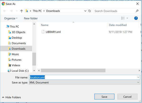

    4. Click the Export Application Definition button on the toolbar (ensure your popup blocker allows popups from the Maximo URL)
    5. Save the resulting XML file to a local or network drive
    6. Edit the LOCATION.XML file with your favorite text editor
    7. Add the following <tab> control to the document after the last <tab> control in the main tab group:

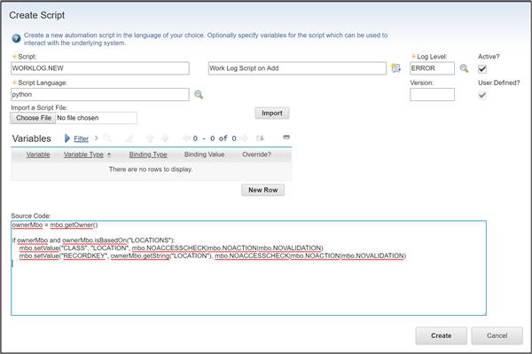

    Step 4: Link the Records
    In order for this to work, we'll need to create a simple Automation Script to link the Work Log entry with its parent Location. This script will fire upon add of a new WORKLOG entry, and will populate the Record Class and Record Key fields on the WORKLOG table from the parent Location record. This ensures that the current Work Log entry is linked to the proper Location.
    1. Log into Maximo as an Administrative user
    2. Navigate to the System Configuration > Platform Configuration > Automation Scripts application.
    3. From the Select Action menu, choose the Create > Script option
      1. Script: WORKLOG.NEW
      2. Description: Work Log Script on Add
      3. Script Language: python
      4. Log Level: ERROR
      5. Active: Yes
    4. Source Code:
      ownerMbo = mbo.getOwner()
      if ownerMbo and ownerMbo.isBasedOn("LOCATIONS"):
          mbo.setValue("CLASS", "LOCATION", mbo.NOACCESSCHECK|mbo.NOACTION|mbo.NOVALIDATION)
          mbo.setValue("RECORDKEY", ownerMbo.getString("LOCATION"), mbo.NOACCESSCHECK|mbo.NOACTION|mbo.NOVALIDATION)
    5. Click the Create button

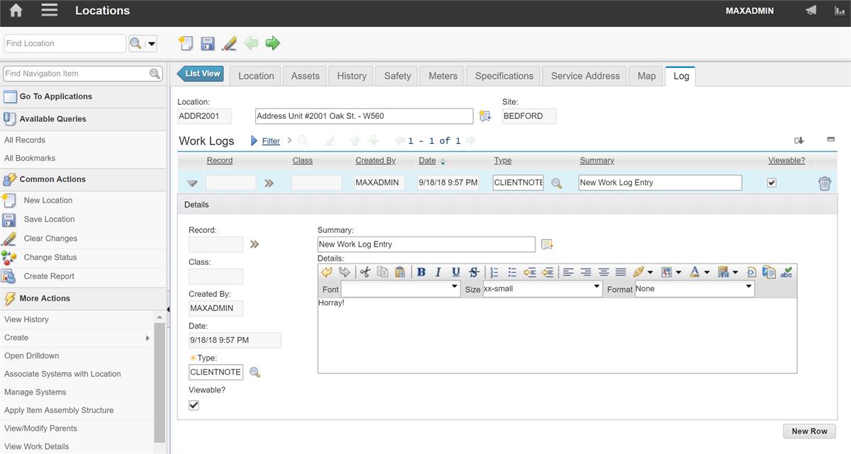

    Step 5: Test the Solution
    Now that it's configured, it is time to try out our solution.
    1. Log into Maximo
    2. Navigate to the Assets > Locations application
    3. Find a Location that you would like to add a new Work Log entry against. In this case, we are looking at the ADDR201 Location from the Maximo Demo database.
    4. Click on the Log tab
    5. Click the New Row button
    6. Fill out the pertinent details
    7. Click the Save button
