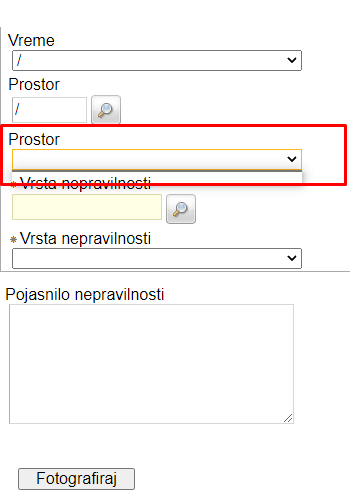

    Hello all,
    We are using Maximo version 7.6.0.10. I have problem with COMBOBOX element in Maximo. Is possible to have TABLEDOMAIN at COMBOBOX?

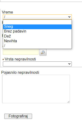

    COMBOBOX:
    This is how this must works -->
    But If I add TABLEDOMAIN at attribute my COMBOBOX wont open anything
    Any idea how to solve this?
    Table domain properly works at TEXTFIELD with lookup :)

    Posted 10-24-2021 20:10
    Combo boxes are cached on page load which I think is probably causing your issue. I'm assuming in the list where on the table domain you're depending on some other attribute that isn't set when the page is loaded. Lookups load when you open the dialog so they're constantly able to refresh based on the data entered.
    I'm not aware of a way to force the combo box to refresh, though I would think it's possible. You'd probably have to get in the weeds of the combo box logic so you'd have to be comfortable reviewing the Maximo code.
