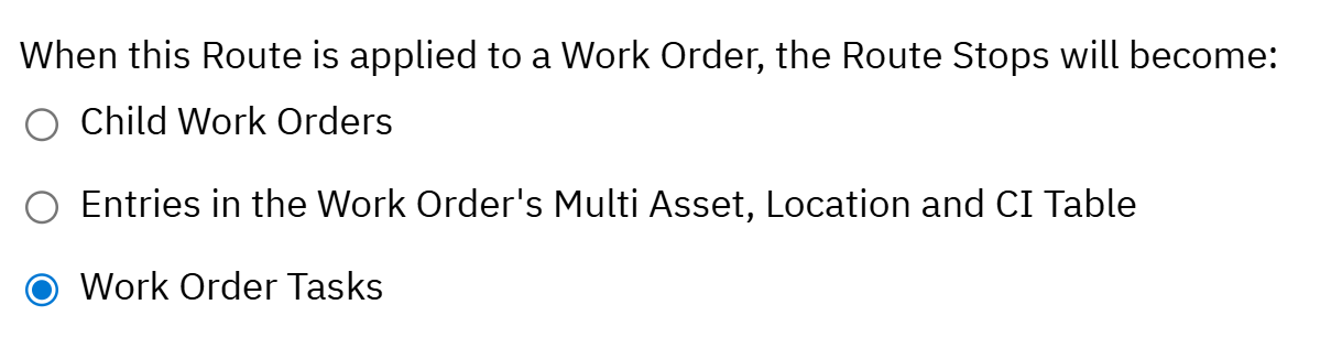

    I created a custom YORN attribute on ROUTE_STOP.  I have configured the route to show up as work order tasks.
    When a PM generates a work order, I want the custom attribute to be copied to the related WOACTIVITY records.
    I'm trying to understand how route or job plan tasks are populated in the WOACTIVITY view, and how difficult it would be to include the custom attribute on those task rows.
