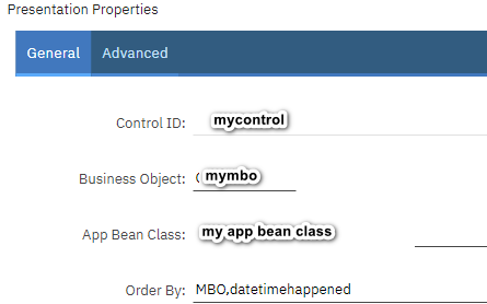

    I made a custom AppBean class based on Bruno Portaluri's example here https://bportaluri.com/2011/08/call-java-method-on-action-menu-or.html.I have a custom MBO and my application shows Records from it.  When I execute the "RunJava", the one in the  More Actions menu command, and turn on the debugger I get it to break on my RunJava method and I can see certain variables coming in. My intent is when a user clicks the "Select Records" Check box and says click one or two rows I want to control or some method to be implemented in my AppBean class. I am stuck at the point where I click one or two rows and then I click Run Java on the left apparently I don't know if the system is actually sending me the two rows I clicked. Secondly, I created a button again called RUNJAVA
    that associated the Signature Option s correctly and put the event RUNJAVA as I had done in the presentation layer they don't work as if I can click on the button but nothing gets sent to the server and doesn't print my debug lines. My guess is my button needs to be part of a DataBean class for Maximo to understand it but I am not sure where exactly in my button or application XML I would specify that. In any case, my first question is what is the minimal amount of code or a method that I should override or create that would accomplish that. You will also notice that the trashcan icon is what I changed appropriately by looking at other applications . At the outset when I click the trash can it puts the two for delete, but I do not know do I have to write anything explicit for that MBO to be deleted as in would I have to write code in the Delete method in my app bean?

    Further to my post : these lines of code sends me the selected rows
    ResultsBean rsb = getResultsBean();
    MboSetRemote rsbMboSet = rsb.getMboSet();
    Vector<MboRemote> selectedMbos = rsbMboSet.getSelection();
    WebClientEvent event = this.clientSession.getCurrentEvent();  //This will show RunJava as the event coming through...
    However, I still don't register anything for Delete, AddRow, my RUNJAVA button, etc(as you can see I am just overriding methods in the debugger and putting loglines as part of my learning)
