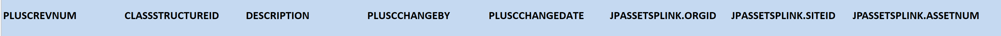

    Hello @Matt McGuire, is it possible to add assets to a Job Plan if the Job Plan does not have an ORG or Siteid?
    I have the below columns filled but still received the error: Internal Server Error
    Error 500: BMXAA2147E - Work asset must have an organization.
