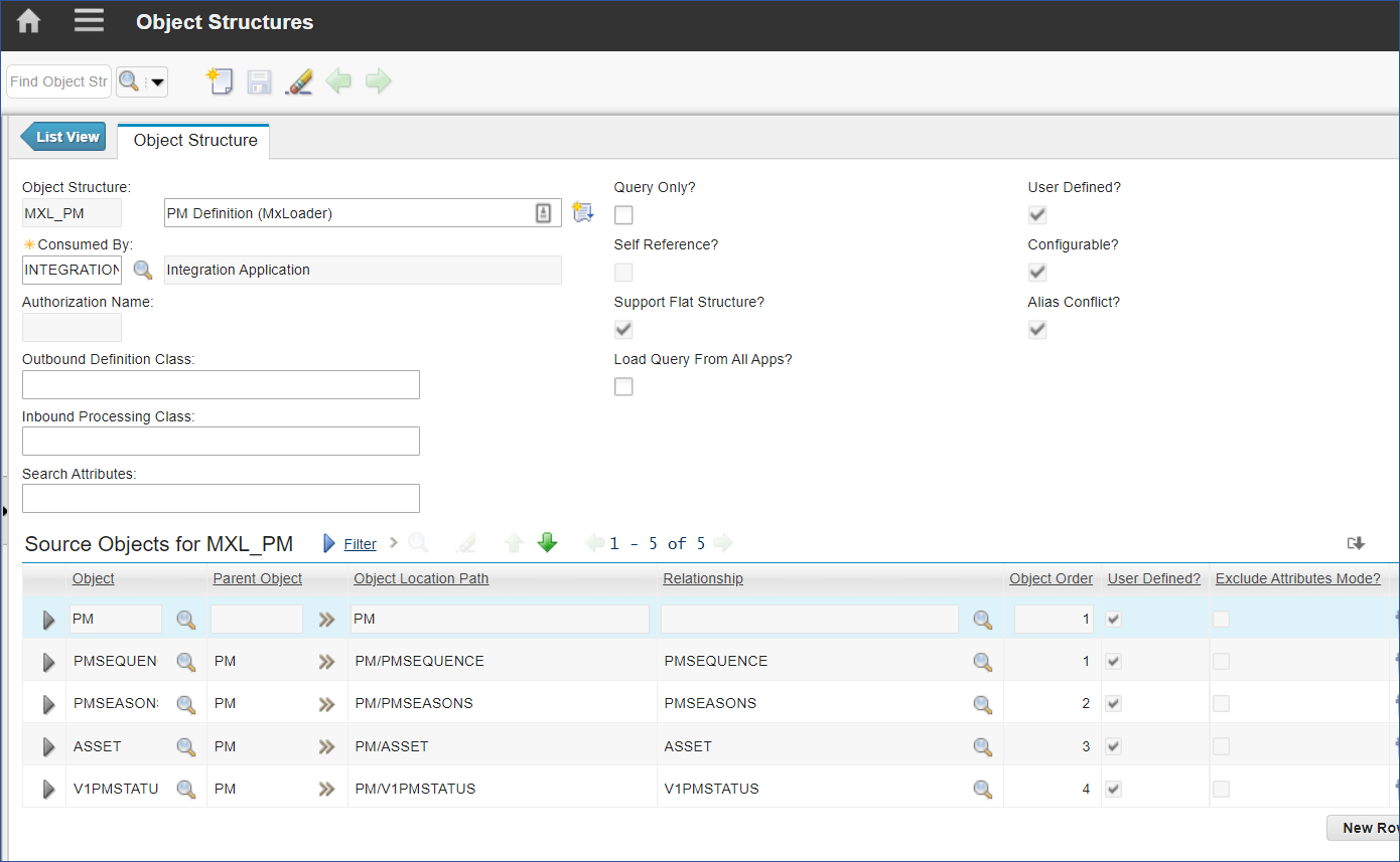

I would first go to the CONFIG tab and click on the Test Connection button to ensure you are hitting the server.
Next, ensure that PMSEQUENCE is list under the
Source Objects for MXL_PM section.

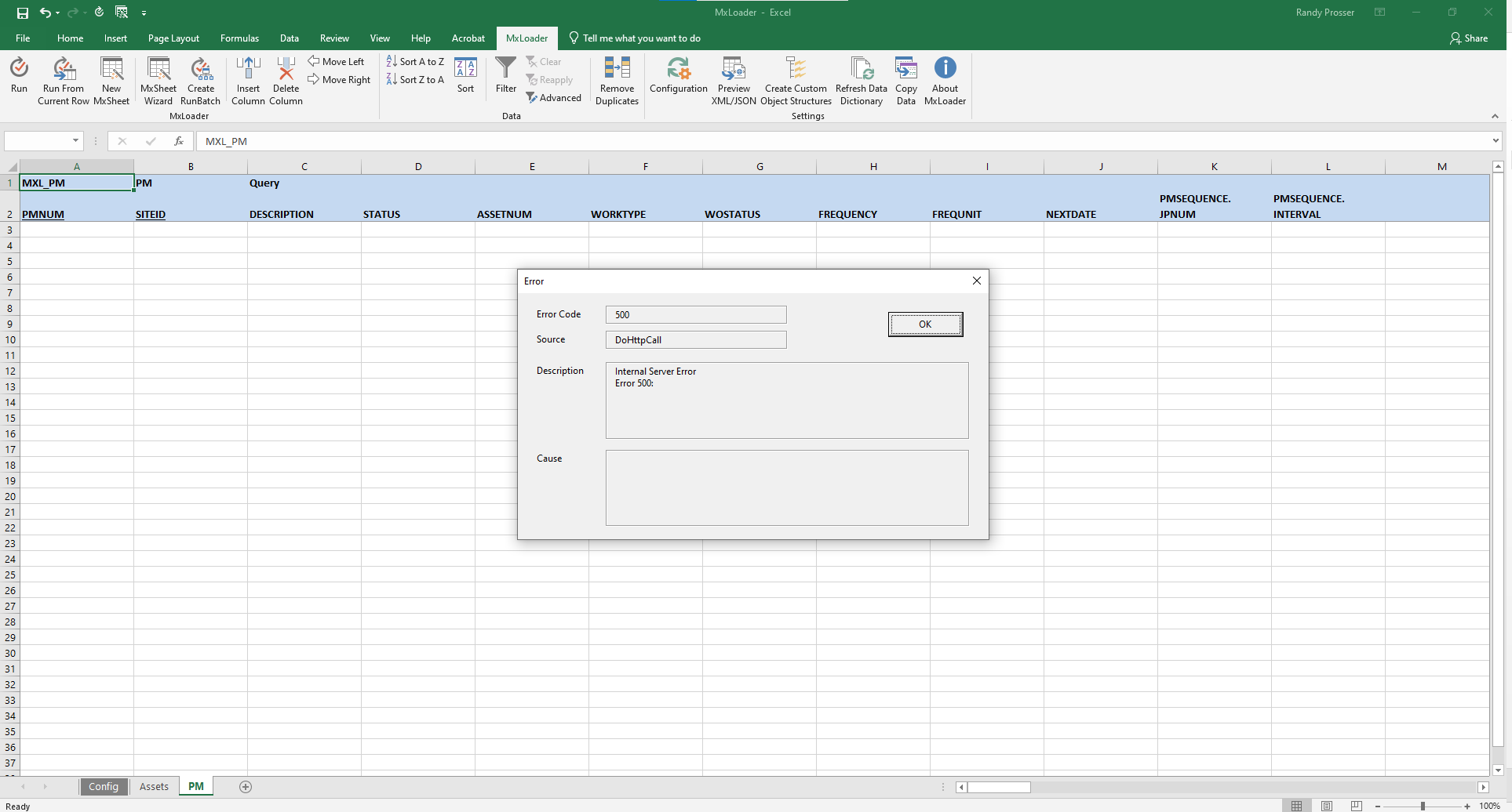

Thanks for looking at this for me. Here is the screen shot. I just selected the MxLoader New MsSheet and then selected Preventive Maintenance - PM with JP Seq. (custom) and then Selected Run and this is what I got.

Hi Randy,
Can you provide more information like the text of the error message? Perhaps you can provide a screenshot of your MxLoader sheet so that we may see the object structure and columns you're using.

Is anyone else getting an error when trying to Query the PM loader sheet? I can query and load from the Assets sheet and the Item sheet. I just get the error on the PM sheet. Thanks for any help or advice.
