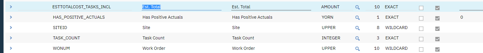

  • 6.  RE: Imported db view: How to set calculated/persistent text attribute Search Type to WILDCARD?
    Posted 11-27-2021 18:08
    Details:
    I loaded these attributes from MxLoader:
    Which were synced successfully to Maximo:
    I don't think that combination of TYPE, LENGTH, SEARCH TYPE, and DEFAULT VALUE was possible via the DB Config UI. It kept making fields be read-only for no reason.
    But as far as I can tell, the MIF/business rules can handle the values ok...the sync from MxLoader worked fine. It was just the Maximo UI that was the problem.
    Notes:
    • For the UPPER fields like WONUM and SITEID, MxLoader didn't sync the LENGTH properly on the first attempt (values just stayed as the defaults). But if I ran the sync a second time, that worked. Not sure what the root cause was.
    • Initially, I had tried using Application Import/Export to sync the attributes. That worked to a degree; it was able to sync everything except the TYPE and LENGTH. So I had developed a process where I did the TYPE and LENGTH via the UI, and then did everything else via Application Import/Export. And that was successful. But ultimately, it was a lot easier just to do everything in MxLoader. Since I didn't have the issue with TYPE and LENGTH in MxLoader.
