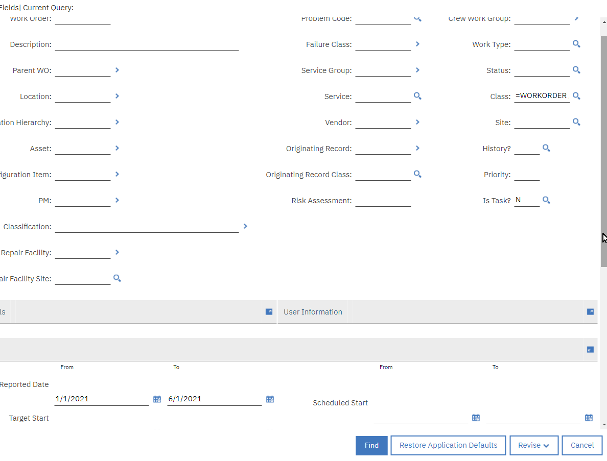

    I am looking for how I may find in Maximo what work orders were created from certain date to certain date please help.

    you can try
    ((woclass = 'WORKORDER' or woclass = 'ACTIVITY') and reportdate <= { ts '2021-06-01 23:59:59.000' } and istask = 0 and reportdate >= { ts '2021-01-01 00:00:00.000' })
    Ultimately, you can just build this in the advanced search.

    Have you tried using the Dates section in the Advanced Search for Work Order Tracking?  You can specify data ranges in there. Be sure note the time that is associated with the date.  You probably want to remove the value for History and keep Is Task as N.
