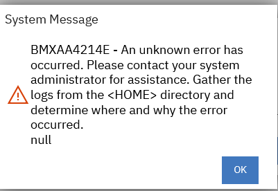

    I can reproduce the same problem manually. When I use Update Budget Lines from the More Actions menu, the process also fails with a similar NullPointerException.

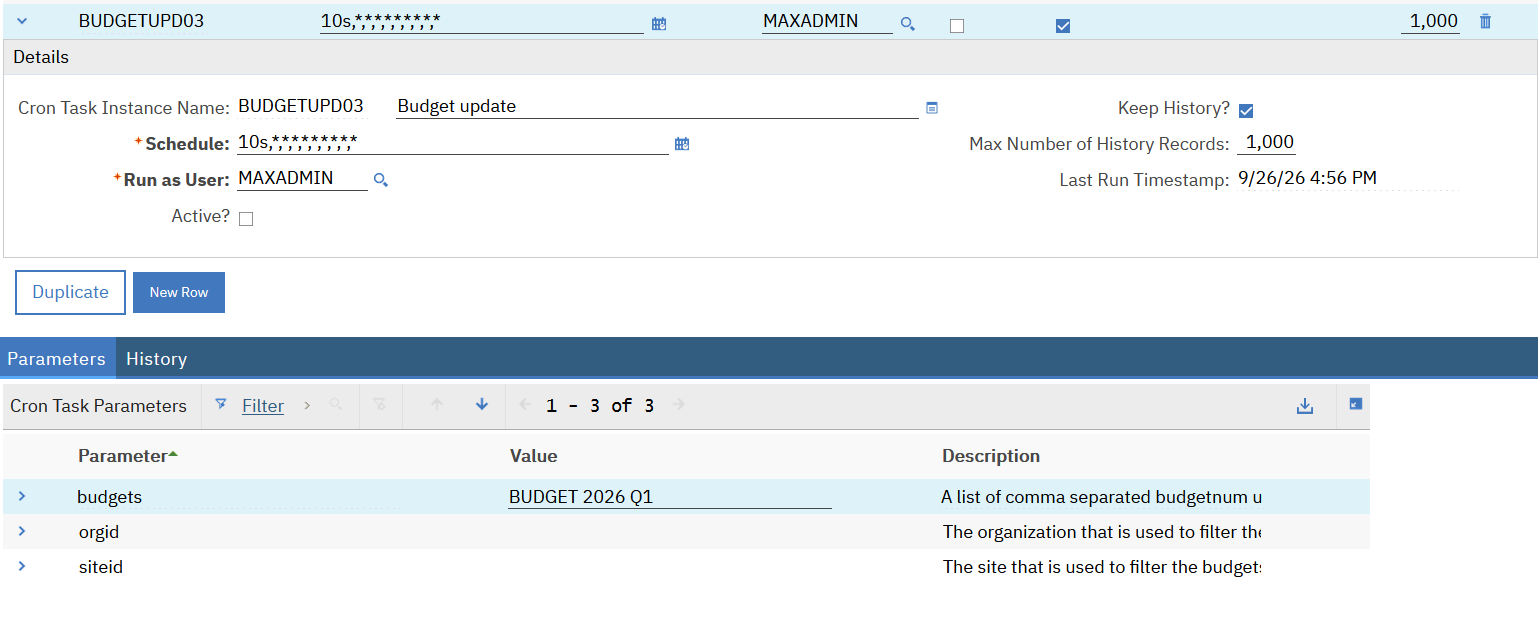

    The Budget Update cron task is configured as follows. I know the 10-second schedule is kinda aggressive, but otherwise Maximo ends up ignoring some transactions.
