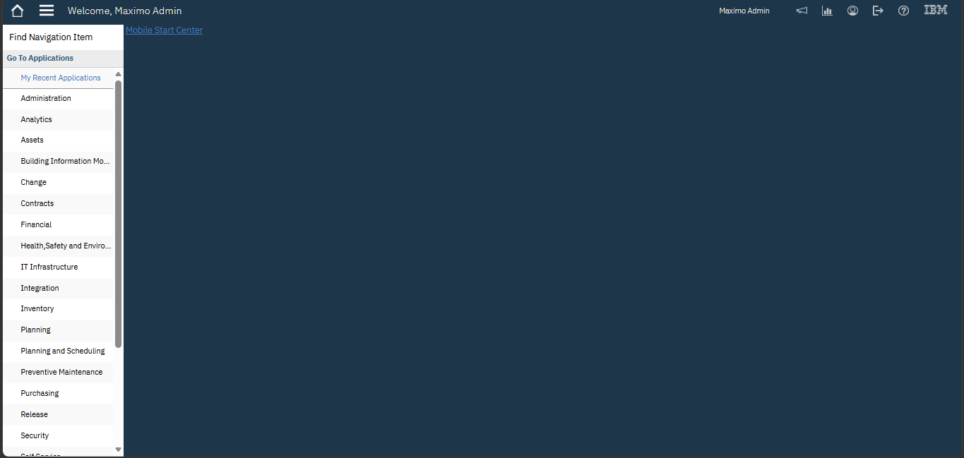

    Here are two refined, professional options you can copy and post directly to the IBM Maximo Community or forum.
    Option 1: Standard & Detailed (Recommended)
    Subject: Start Center blank for MAXADMIN users after dynamic dashboard edit
    Hi everyone,
    I recently encountered an issue while modifying a Start Center dynamic dashboard. During the process of saving and re-editing the layout, the browser session unexpectedly refreshed. Following the reload, the Start Center rendered completely blank for my session.
    Upon further investigation, we identified the following behavior:
    • Impacted Scope: The issue selectively impacts users belonging to the MAXADMIN security group. Non-admin users are unaffected and can view their assigned Start Centers normally.
    • Troubleshooting Performed: We have attempted logging out/in, clearing browser cache and cookies, and testing across different client machines/browsers, but the Start Center remains blank for all MAXADMIN accounts.
    It appears the dynamic layout modification may have corrupted the underlying database configuration or XML template for that specific Start Center layout.
    Could anyone advise on the recommended steps to reset or recover this Start Center? Specifically:
    1. Which core tables (LAYOUT, SCTEMPLATE, STARTCENTER, etc.) should be checked to clear or restore the broken configuration?
    2. Is there a safe SQL script or Admin Tool procedure to revert the default Start Center for affected security groups back to a functional state?
    Thanks in advance for your assistance!

    I'm not sure that I have ever seen this scenario. Even when you edit the start center template, other users shouldn't see the changes until they manually update their start center. Maximo makes a copy for each user in the scconfig, layout, etc. tables.
    I think you need to start by determining if the template has been deleted. If that's the case, you won't be able to recover from your existing database. To do that, you start from sctemplate table and try and find the template you're interested in.
    If you find the start center template, and everything looks good in the presentation column, then you want to the scconfig object and search where the sctemplateid matches your sctemplateid from the sctemplate object.
    If you have a sctemplate but do not see anything in the scconfig table, it means Maximo doesn't think this is assigned to any user. Someone may have removed it from a security group, and the fix is to simply apply the start center to the security group in the Security Groups application. Then when the user logs out and logs back in, Maximo will create it again from the template.
    If your users have scconfig (I assume they don't based on your screenshot), you can try to remove the data to force Maximo to rebuild from the start center template. I would test this by deleting the scconfig for a single user with a query like below (replacing :SCCONFIG_TO_DELETE with the ID of the SCCONFIG)
    DELETE FROM rsconfig WHERE layoutid IN (SELECT layoutid FROM layout WHERE scconfigid = :SCCONFIG_TO_DELETE)
    DELETE FROM faconfig WHERE layoutid IN (SELECT layoutid FROM layout WHERE scconfigid = :SCCONFIG_TO_DELETE)
    DELETE FROM inbxconfig WHERE layoutid IN (SELECT layoutid FROM layout WHERE scconfigid = :SCCONFIG_TO_DELETE)
    DELETE FROM kpilconfig WHERE layoutid IN (SELECT layoutid FROM layout WHERE scconfigid = :SCCONFIG_TO_DELETE)
    DELETE FROM kpigconfig WHERE layoutid IN (SELECT layoutid FROM layout WHERE scconfigid = :SCCONFIG_TO_DELETE)
    DELETE FROM actionscfg WHERE layoutid IN (SELECT layoutid FROM layout WHERE scconfigid = :SCCONFIG_TO_DELETE)
    DELETE FROM portletdisplay WHERE layoutid IN (SELECT layoutid FROM layout WHERE scconfigid = :SCCONFIG_TO_DELETE)
    DELETE FROM reportlistcfg WHERE layoutid IN (SELECT layoutid FROM layout WHERE scconfigid = :SCCONFIG_TO_DELETE)
    DELETE FROM layout WHERE scconfigid = :SCCONFIG_TO_DELETE))
    DELETE FROM scconfig WHERE scconfigid = :SCCONFIG_TO_DELETE))
    You could then expand on this to find all scconfigid that match that sctemplateid to bulk delete the rest.
    If the template is missing, your only option is to recover it from a backup. Maximo doesn't have history tracking of this.

    There could be a strong chance that you're right, but from possibly a different perspective, though same solution.  What we don't know is if that user has created the start center template, but never saved it.  Thus, until they save it, it will appear as it they are assigned it.  When they did save it, of course, it disappears because it was not assigned to a security group that they belonged to.
    Rather then over complicating this with DB queries, how about just use the Edit Existing Template (the pencil icon) on the start center screen?
    Oh, but wait! From the screenshot we cannot see these icons.  Have the user check that they have the rights assigned in order to do this.
    In summary:
    1. Check you have rights to edit an existing template
    2. Check using the edit template that your template exists
    3. Use Steven's solution if all else fails.
    Please let us know that answer.

    Thank you Steven, your help was invaluable in identifying and resolving this problem.
    Here is the troubleshooting guide I followed to fix the issue:
    # Maximo Start Center Blank Screen / Crash - Troubleshooting Guide
    ## Problem
    Two symptoms, same root cause:
    1. **Start Center loads blank** after login - no dashboard, no portlets, no on-screen error. The page just sits empty.
    2. **The dashboard suddenly crashes specifically when editing or saving it** - not while just viewing it. You'll see:
       BMXAA4211E - Database error number -803 has occurred when operating on LAYOUT : Layout=25670.
    > 🔑 **Key clue:** if the crash only happens on **Edit / Save**, and the dashboard is otherwise viewable fine, that's a strong sign you're hitting this exact issue. Viewing a dashboard only *reads* data, but editing/saving *writes* new records - and that's the moment Maximo collides with a leftover duplicate key in the database (see Root Cause below).
    This guide covers both symptoms, since they come from the same root cause.
    ## Root Cause
    Maximo stores each user's dashboard in two tables:
    | Table | What it holds |
    | `SCCONFIG` | The Start Center "config" - one row per user + security group combo |
    | `LAYOUT` | The individual portlets/widgets inside that dashboard |
    Both tables have a **unique index** that must never have duplicate values:
    - `SCCONFIG` → unique on `(USERID, GROUPNAME)`
    - `LAYOUT` → unique on `CONTENTUID`
    **The crash happens when Maximo tries to insert a new row that collides with an existing one in these unique indexes** - usually left over from a previous group/Start Center reassignment while a session was still active. Instead of showing a proper error, the Start Center bean throws an exception during page load, and the browser just shows a blank screen.
    Database error code **`-803`** = "duplicate key violation" (DB2). If you're on a different database, look for an equivalent unique-constraint error.
    ## Step 1: Confirm it's this issue
    Check the application server log (`SystemOut.log` / `SystemErr.log`) around the time of the crash. Look for:
    BMXAA4211E - Database error number -803 has occurred when operating on SCCONFIG
    or
    If you see this, along with a stack trace mentioning `SCConfigService`, `StartCenterAppBean`, or `StartCenter.initialize` - you're in the right place.
    ## Step 2: Fix a blank Start Center (SCCONFIG issue)
    1. **Back up the row first** - always, before deleting anything:
       ```sql
       SELECT * FROM SCCONFIG WHERE USERID = 'YOUR_USER' AND GROUPNAME = 'YOUR_GROUP';
       Copy this result somewhere safe (spreadsheet, CSV, notes).
    2. **Delete that row** by its unique `SCCONFIGID`:
       ```sql
       DELETE FROM SCCONFIG WHERE SCCONFIGID = <the ID from step 1>;
    3. **Log out completely and log back in.** Maximo will automatically create a fresh `SCCONFIG` row for that user/group - this usually fixes the blank screen immediately.
    > ⚠️ **Do not restore the deleted row from your backup.** Once you log back in, Maximo creates a brand-new row for that same user/group. Re-inserting the old one will just recreate the duplicate-key collision.
    ## Step 3: Fix the "-803 on LAYOUT" error (can't save/edit dashboard)
    This happens because deleting the `SCCONFIG` row in Step 2 does **not** automatically delete its child `LAYOUT` rows (the portlets). Those old rows are left behind ("orphaned"), still holding onto `CONTENTUID` values. When you try to save a new/edited dashboard, Maximo tries to reuse a `CONTENTUID` that's still stuck in one of those orphaned rows - causing the collision.
    1. **Find the orphaned rows**, using the *old* `SCCONFIGID` you deleted in Step 2:
       ```sql
       SELECT LAYOUTID, PORTLETID, DESCRIPTION, SCCONFIGID, CONTENTUID
       FROM LAYOUT
       WHERE SCCONFIGID = <the old SCCONFIGID you deleted>;
    2. **Confirm these are actually orphaned** - check your *current* active dashboard's `SCCONFIGID` (it will be a different, newer number):
       ```sql
       If the `SCCONFIGID` here is different from the one in step 1, the `LAYOUT` rows tied to the old ID are safe to remove.
    3. **Delete the orphaned LAYOUT rows:**
       ```sql
       DELETE FROM LAYOUT WHERE SCCONFIGID = <the old, now-deleted SCCONFIGID>;
    4. **Log out and back in**, then try editing/saving the dashboard again. The error should be gone.
    ## Step 4 (Recommended, faster in practice): Clone the Dashboard Instead
    Rather than hunting down every orphaned row, it's often quicker and safer to just **clone the affected dashboard as a new one**:
    1. Go to your Start Center.
    2. Use the **clone/copy dashboard** option to create a fresh copy under a new name.
    3. Delete or stop using the old broken one.
    4. Continue working from the clone.
    This sidesteps any other hidden orphaned rows we may not have found, since the clone gets entirely fresh `CONTENTUID` and `LAYOUT` records.
    âś… **This is the approach that worked in our case** and is recommended as the first thing to try if Step 3 feels too risky or time-consuming.
    ## Quick Reference Summary
    | Symptom | Cause | Fix |
    | Start Center loads blank | Duplicate row in `SCCONFIG` | Delete the old row → re-login (Maximo recreates it) |
    | `-803` error on `LAYOUT` when saving dashboard | Orphaned `LAYOUT` rows from the deleted `SCCONFIG` row | Delete orphaned `LAYOUT` rows tied to the old `SCCONFIGID`, **or** just clone the dashboard |
    ## Prevention Tips
    - Avoid changing a user's security group / Start Center assignment while they have an active Maximo session - log them out first.
    - If a Start Center config needs to be reset, always delete the **whole chain** (`SCCONFIG` row *and* its related `LAYOUT` rows) together, not just one table.
    - Keep a habit of backing up (`SELECT *` into a CSV) any row before deleting it - even if you don't end up restoring it, it helps confirm root cause later.
    *Document based on a real troubleshooting case - Maximo (DB2 backend). Adjust catalog/system queries (`SYSCAT.*`) if using Oracle or SQL Server.*
