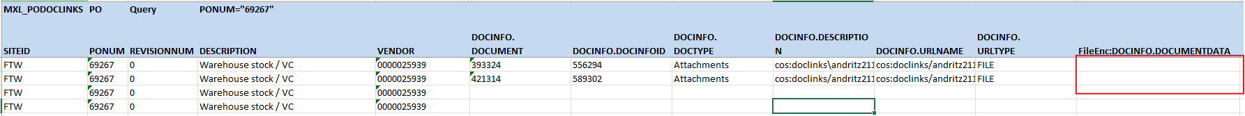

    Testing 1, Parent Object PO, Child Objects DOCLINKS and DOCINFO. Nothing returns for DOCINFO.DOCUMENTDATA in loader and no folder is created in the loader file location, all fields are included in the OS(I tried DOCLINKS.DOCUMENTDATA here as well, same result):

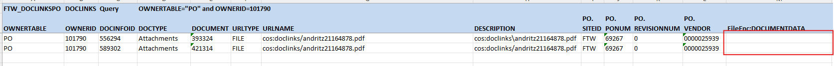

    Testing 2, Parent Object DOCLINKS, Child Object PO. Nothing returns for DOCLINKS.DOCUMENTDATA in loader and no folder is created in the loader file location, all fields are included in the OS:

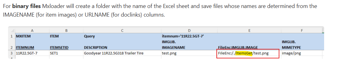

    I have included a screenshot from the example from Bruno on how to download attachments using Enc for binary files: Binary and text files handling in MxLoader 8.5 – Bruno Portaluri (MaximoDev)  Where would the ItemsGet folder be defined?  Is it the name of the sheet in the loader?
