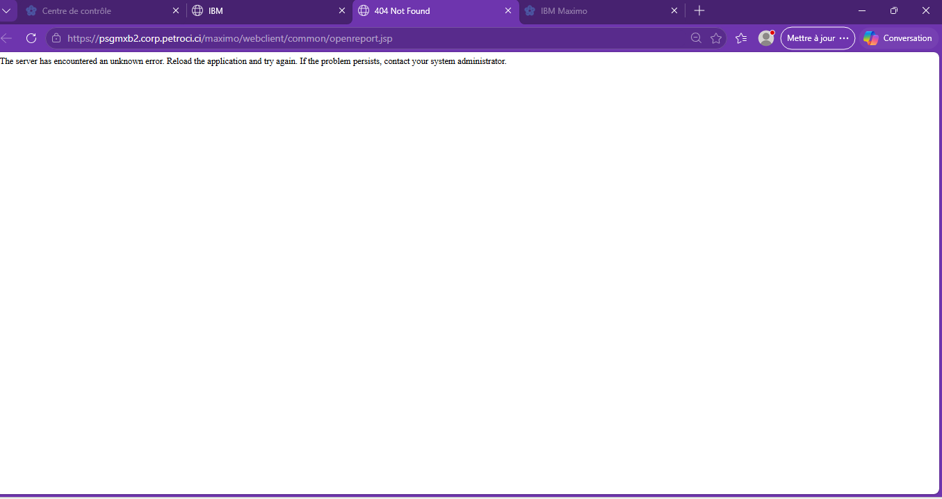

    HELLO EVERYONE,
    WHEN I PRINT REPORT IN HTTPS SESSION I GET ERROR
    #Reporting

    Do you have the text of the error or a screenshot?
    I would be surprised if it's related to HTTPS, but because you called it out, are you saying that when you access the system using HTTP (hitting it on port 9080 for example) that printing the report works?
    And what version of Maximo are you using?

    HELLO,
    Please find the error screeshot

    Can you provide a copy of the text of the error?
    Is the report window showing a dialog box? If the dialog box shows a "More information" link then click on that and provide that information or make it available in your reply.
    Do you have access to the log file for the POD file that is running the BIRT report?
    If this is running in a Maximo 7.* environment then please check the SystemOut/SystemErr log files
    Please provide the full system information information to help us understand which things could be a problem.
    Responders will be able to provide a lot more help if you provide these extra details

    thanks for posting that screenshot. When the BIRT report engine encounters an error it will write a generic message to the window and that is what you are seeing.
    the important/valuable error message will be written to the log files:
    Maximo 7.* -  JVM SystemOut/SystemErr log files.
    MAS Manage - POD log file
    You need to look through those log files for text like ERROR / Exception
    The log file will give you the key information that you/we need to identify the root cause
