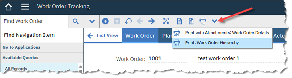

    How can I add a report to the toolbar menu print drop down?

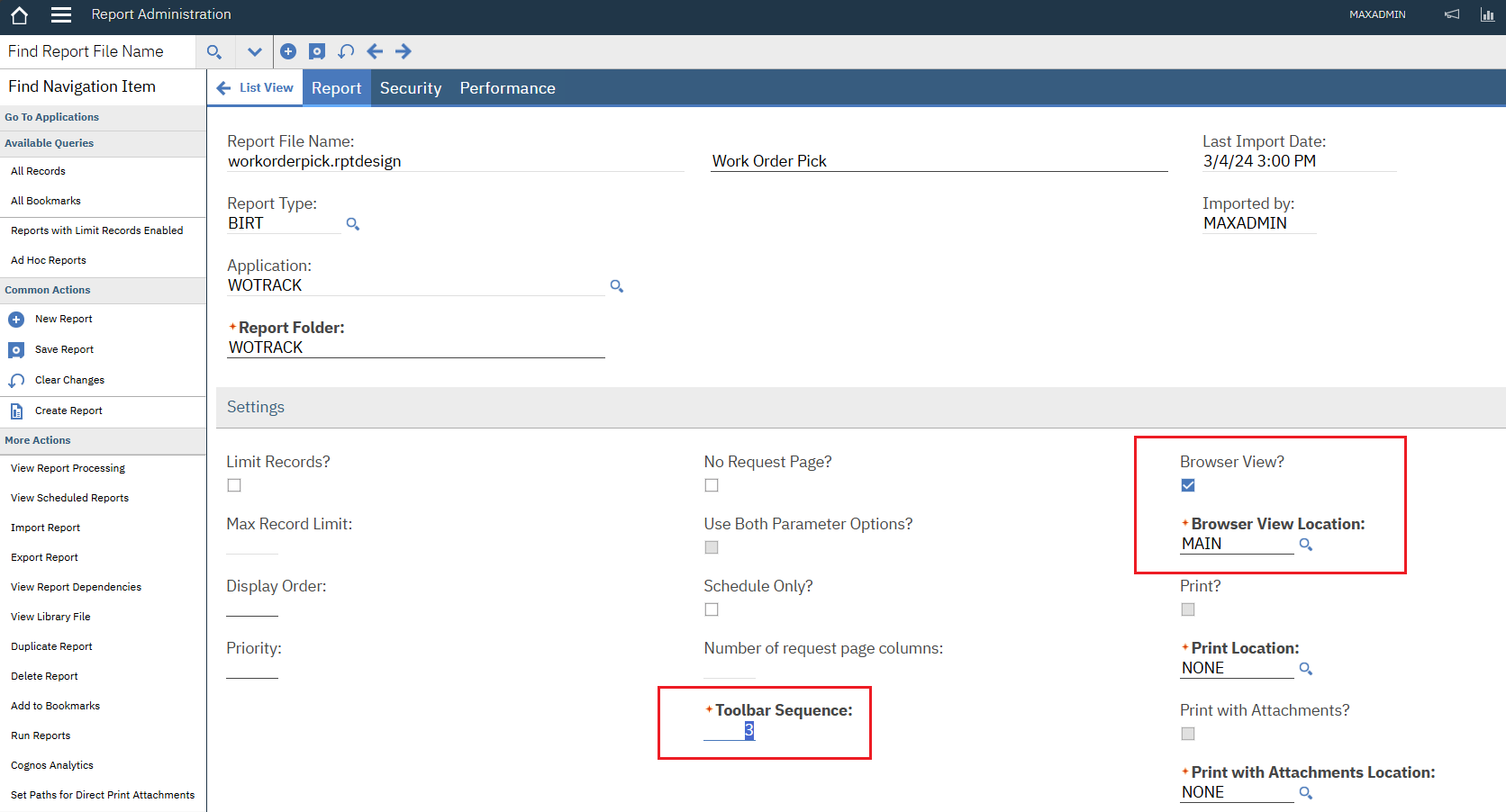

    This is configured under Report Administration. You will need to choose a report that has no parameters. Set the print option to get the print action.

    That worked, thank you so much.
