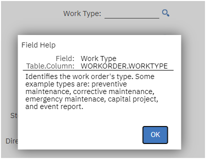

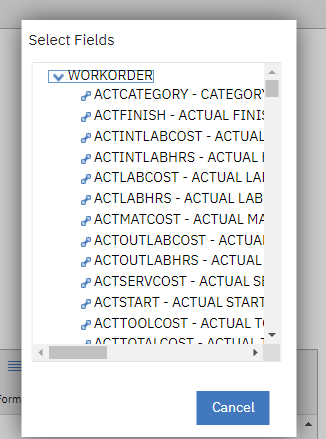

Let's take Q1. In the following screenshot from the Work Order Tracking application, you want to include the Work Type field. In the first instance, you can use the field help and it shows WORKORDER.WORKTYPE. So, on the tree as it starts with WORKORDER, that's the first part, then simply looking down the tree look for WORKTYPE. On selection, it will return :WORKTYPE. As there is no period (fullstop), it means that it is a field belonging to the object WORKORDER.

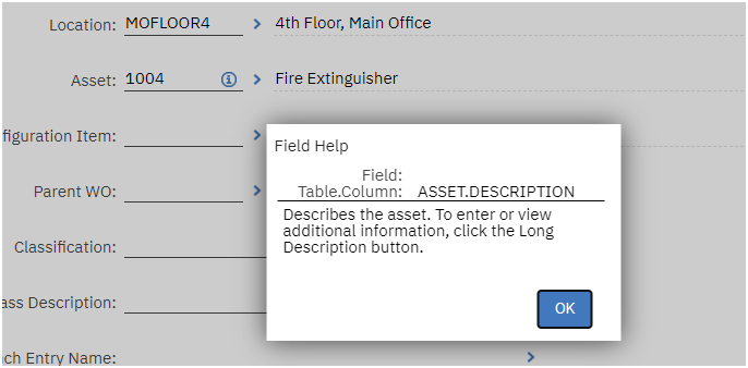

Now, looking at the Asset field and more specifically, the Asset's description, you can see that it is ASSET.DESCRIPTION. As the first part is not WORKORDER it means that you are access the description via a relationship.

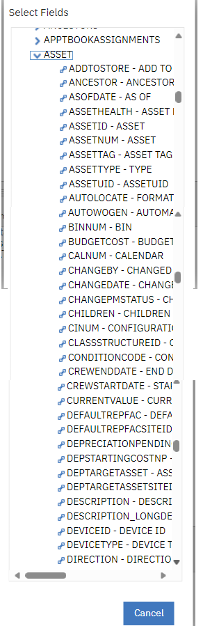

If you scroll down, you will see an arrow with the name of the relationship ASSET and once you open that and scroll down on that part of the tree, you will come across DESCRIPTION. Once you select that it will return :ASSET.DESCRIPTION. I hope that you can see the difference between the first example and the second. That answers Q1.
