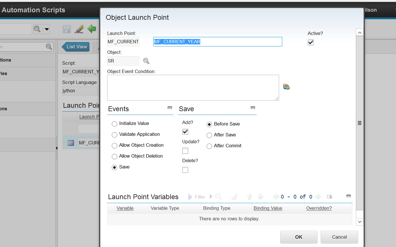

  • 4.  RE: Automation script - Please Help
    Posted 07-26-2024 09:57
    Darwin,
    If you want to save the current year only when you create a new SR, this jython script on SR OBJECT solves it:
    # Script: set_current_year_on_create.py
    # Descripción: Save current year on field "CURR_YEAR" when you create a new SR
    from psdi.server import MXServer
    from java.util import Calendar
    # Get current year
    current_year = Calendar.getInstance().get(Calendar.YEAR)
    # Set the value of the persistent field
    mbo.setValue("CURR_YEAR", current_year)
    Then I will try to pass you the other one, when the SR object is modified.

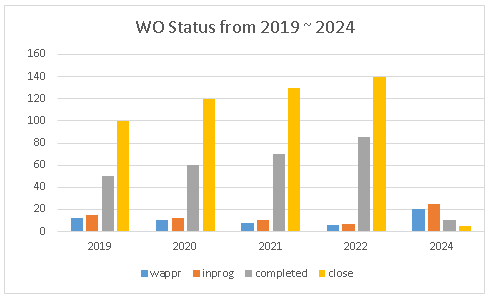

  • 5.  RE: Automation script - Please Help
    Posted 07-28-2024 20:24
    HI Martin,
    Thanks thanks thanks. This really works for me.
    What Im trying to achieve is to put this script-field on dashboard and use it in result set like in picture below.
    Darwin Bagangan
    GNPOWER
