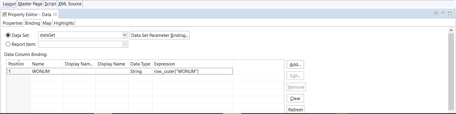

Original Message:
Sent: 12-12-2023 12:20
From: Bob Kraus
Subject: BIRT 4.8 Error
WONUM is not GetInteger, it is GetString.
| Bob Kraus | | Senior Business Services Consultant | Facilities Services | Missouri S&T | |
| General Services Bldg, 1701 Spruce Dr, Rolla, MO 65409 | | |

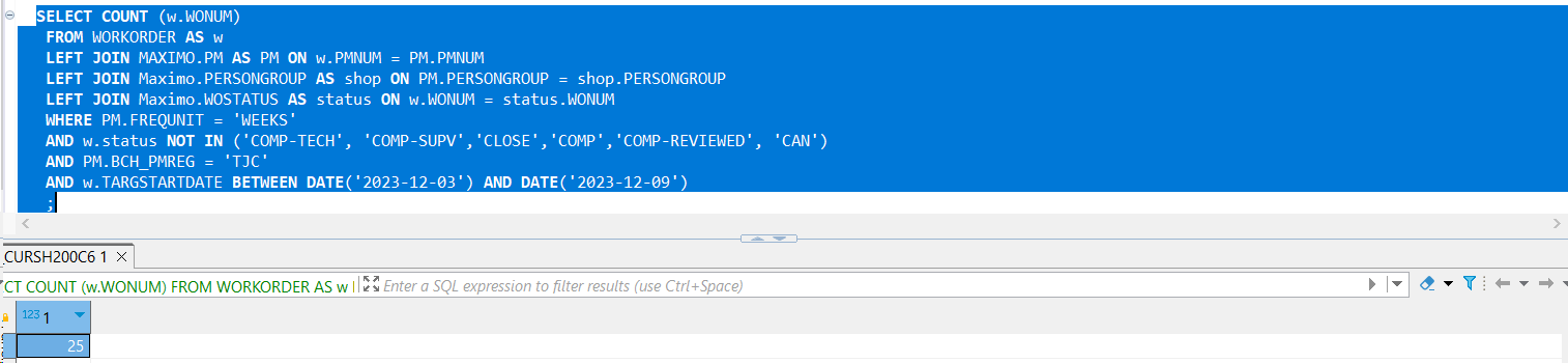

Original Message:
Sent: 12/12/2023 11:53:00 AM
From: Philip Marrone
Subject: RE: BIRT 4.8 Error
Hello again,
I ran in SQL and get 25 records. However, when I went back to run it again it runs as though the fetch script is null, even though I have not changed anything since the last time testing the report. Fetch script is still as I captured above (when it did work), and now I get the following stack trace error:

If your result comes up blank without any errors, recheck your SQL select statement.
Can you clean it and run it in SQL to see what the number of records should be?

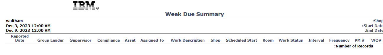

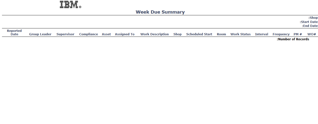

Thank you, good sir. I have gotten further than before, but the report comes up blank:
I thought perhaps that something was wrong with my column bindings, but from my limited knowledge they appear to be okay:
Fetch script, just incase it is relevant here:

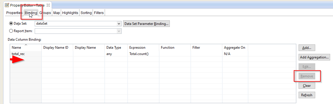

Go to the Layout Tab.
Click the corner of the layout and click on Table (not Grid)
Click on the Binding Tab. Here you can add, remove etc.

datewhere += " AND w.TARGSTARTDATE <= " + MXReportSqlFormat.getEndDayTimestampFunction(params["enddate"]);
var sqlText = "SELECT "
+ "w.WONUM AS 'Work Order', "
+ "PM.FREQUENCY AS 'Frequency', "
+ "PM.FREQUNIT AS 'Interval', "
+ "w.LOCATION AS 'ROOM', "
+ "TO_CHAR(w.SCHEDSTART, 'MM/DD/YY') AS 'Scheduled Start', "
+ "TO_CHAR(w.REPORTDATE, 'MM/DD/YY') AS 'Reported Date', "
+ "UPPER(w.DESCRIPTION) AS 'Description', "
+ "shop.BCH_PARshop AS 'Parent shop', "
+ "w.PERSONGROUP AS 'Shop', "
+ "w.ASSETNUM AS 'Equipment', "
+ "w.Status AS 'Status', "
+ "w.LEAD AS 'Assigned To', "
+ "pm.BCH_PMREG AS 'Compliance', "
+ "w.PMNUM AS 'PM', "
+ "shop.BCH_GRPLDR AS 'Group Leader', "
+ "shop.BCH_shopSUP AS 'Supervisor' "
+ "FROM WORKORDER AS w "
+ "LEFT JOIN MAXIMO.PM AS PM ON w.PMNUM = PM.PMNUM "
+ "LEFT JOIN Maximo.PERSONGROUP AS shop ON PM.PERSONGROUP = shop.PERSONGROUP "
+ "LEFT JOIN Maximo.WOSTATUS AS status ON w.WONUM = status.WONUM "
+ "WHERE PM.FREQUNIT = 'WEEKS' "
+ "AND w.status NOT IN ('COMP-TECH', 'COMP-SUPV','CLOSE','COMP','COMP-REVIEWED', 'CAN') "
+ "AND PM.BCH_PMREG = 'TJC' "
+ "AND w.TARGSTARTDATE BETWEEN DATE('2023-12-03') AND DATE('2023-12-09') "
+ "AND " + shopwhere + " "
+ "AND " + datewhere;
maximoDataSet.setQuery(sqlText);
