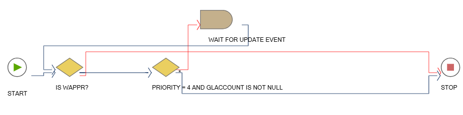

    Hello All,
    I have encountered an issue where a deployed workflow is altering a communication template used in the workflow, anyone else encountred a similar issue?  Some of the items tested to debug the issue:
    1. Disabling all automation scripts
    2. Disabling other work flows
    3. Disabling escalations
