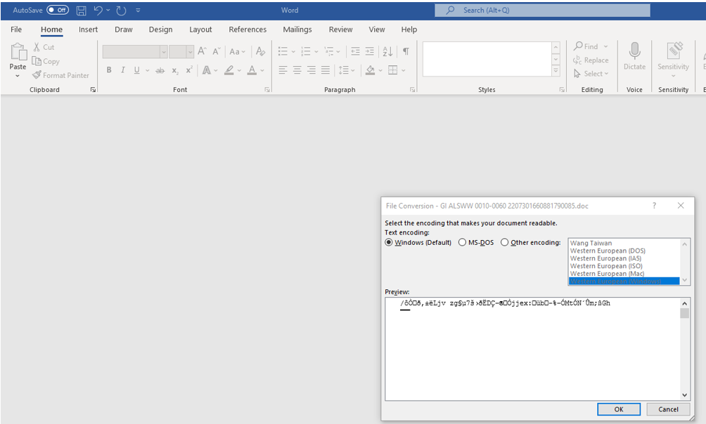

The issue now is that when trying to open the document in the above screenshot, MS Word is showing the following:
This suggests that the Word document is corrupt. When I manually attach the same document from the front end, then it can be opened without any issue.

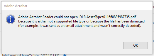

And the same thing is happening with all document types from URLs: .pdf error:
Anyone has any ideas what's going on here?

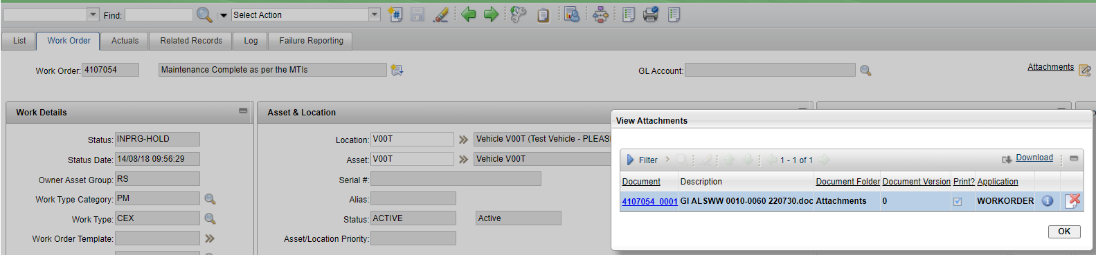

I'm struggling to understand where I'm going wrong with file attachments. I've successfully uploaded documents against Work Orders with MxLoader (7.5.2) but then found to my amazement that the document attachments are useless because they become unrecognisable files in Maximo and therefore cannot be opened. The document looks like this in Maximo after upload:
On the surface, everything appears normal, but when I click on any document, it downloads and looks not like the original document but like this:
When I attach the same document manually from the front end, it opens like the original document.
