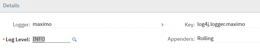

    To get Maximo logs to output to your file, you need to associate the appender to loggers. I tried to call this out in my first message but if you look at the Manage Maximo Root Logger
    You can see what appenders are associated to it. You likely see Console here and would want to associate the Rolling appender (or whatever appender you defined in the Manage Appenders dialog) by clicking the button next to the appender. NOTE: we disable Maximo logs in 7.6 environments from writing to the SystemOut by removing the Console appender to leave it to only the WebSphere events/code that writes to the console rather than using a Maximo logger.
    Once you're done with the changes, you must click the Apply Settings action. Log settings are maintained in a cache and it will not take effect unless you do this or restart the system.
