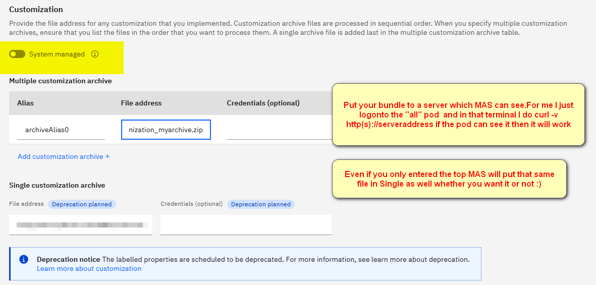

  • 5.  RE: MAS 9 - Hosting of customization archives files
    Posted 10-03-2025 11:57
    Edited by Appu nair 10-03-2025 11:58
    Inside the screen to put your customization archive, you have these options so as the suite administrator one should find the customization section using the update configuration. Once you do that, you will see many pod activities like config build,adminbuild,allbuild and so on and so long as the archive has files understanable to maximo.You can also use maxmanagedev-cli using oc and Docker behind the covers
    if the files are un reachable then MAS will keep on trying 20 times then it will start another build try 20 times and in that process may crash the cluster as well.
    Appu nair
    APPECM
