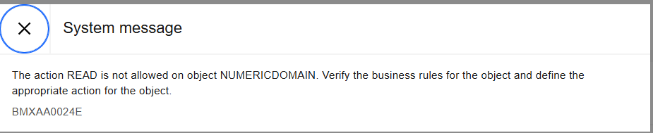

    We recently migrated over to MAS 9.  I am doing some configuration on Service Requests through the Role based applications.  I put a portlet on each start center and set up the security access for each user.  However, when they try to submit a service request they are able to select the issue and the subcategory but cannot go any further.  They are getting an error and it just spins.  Does anyone have any information on this?  Not sure if we missed a security access somewhere.  See error below.

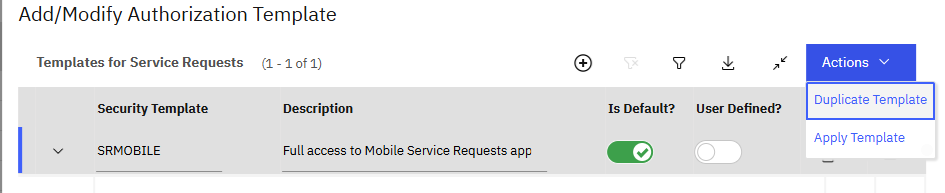

    Make sure you apply the security template for the Service Requests application in the Security Groups application. These applications use a series of object structures and new ones are added in patches so you should do this anytime you patch Maximo.
    For each group you want to access, filter for Service Request in the Description and ensure the Application Type is Tools and Tasks (this is the new role-based/Mobile version).

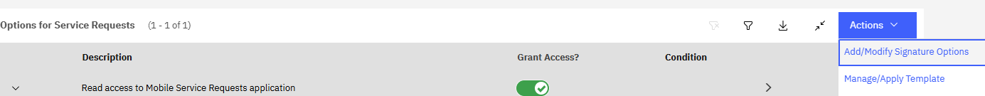

    Hit the Actions->Manage/Apply Template
    Then in the Actions->Apply Template

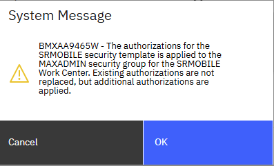

    Click OK when you are presented with the system message.
    Then make sure you log out of all sessions and log back in.

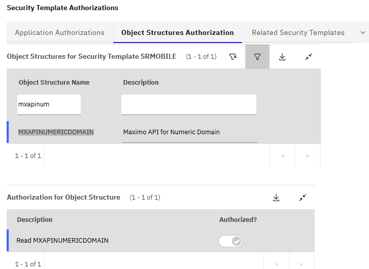

    If that is still not working, make sure the MXAPINUMERICDOMAIN object structure is part of the security template. It should be out of the box, and it was in our environment.
    Follow the steps up to but not including the Apply Template. At the bottom of that dialog is the Security Template Authorizations section which will detail every permission that will be granted. Click the two arrows to expand it.
    Then switch to the Object Structures Authorization and filter for MXAPINUMERICDOMAIN
    You should see that it is granting READ.

    Thank you so much!  Applying the template worked.   I was going in the right  direction then when I got that pop up when I applied it yesterday I was worried going through would break something so I backed out.  I really appreciate your help.
