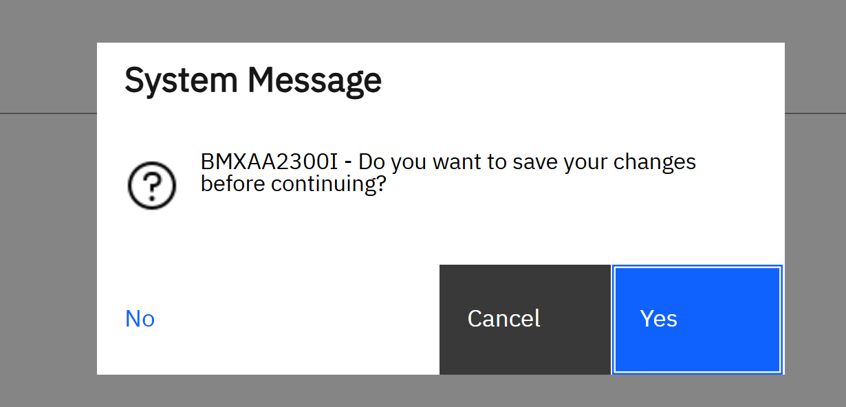

    Hello all, I believe MAS Manage is a lot more customizable than 7.6.  So I was curious if there is a way to edit these button colors/backgrounds.

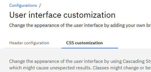

    Give this a go under CSS Customization

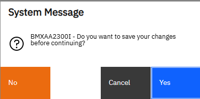

    Checks for "White: #ffffff" updates background to "Orange : #eb6b0f
    Updates background color to "Orange : #f8781c"
    .dsc1 .dbottom div[ctype="buttongroup"][data-three-buttons="true"] button.pb:first-of-type,
    #msgbox-dialog_inner div[ctype="buttongroup"][data-three-buttons="true"] button.pb:first-of-type {
        margin-inline-end: 25% !important;
        background: #eb6b0f;
        color: #ffffff !important;
    .dsc1 .dbottom div[ctype="buttongroup"][data-three-buttons="true"] button.pb:first-of-type:hover,
    #msgbox-dialog_inner div[ctype="buttongroup"][data-three-buttons="true"] button.pb:first-of-type:hover {
        background-color: #f8781c !important;
