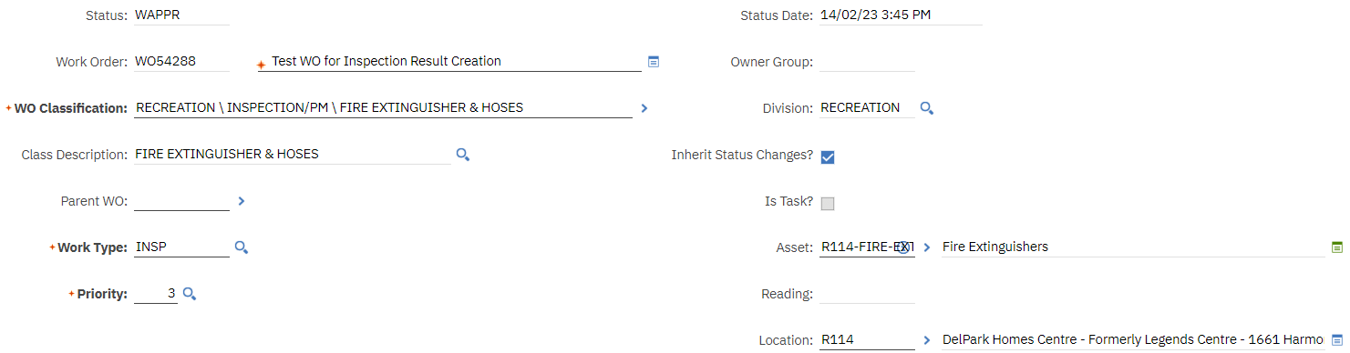

I created a new Work Order and only added one Asset "R114-FIRE-EXTING" to it at 2023-02-14 3:45PM.

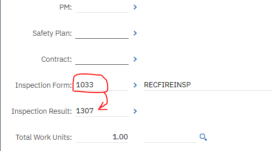

And then once I select "Inspection Form" for this Work Order above, it will then generate new Inspection Result.

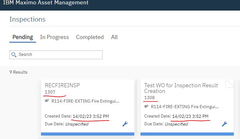

It is supposed to only generate one Inspection Result "1307", but actually it always generates an additional Inspection Result:
