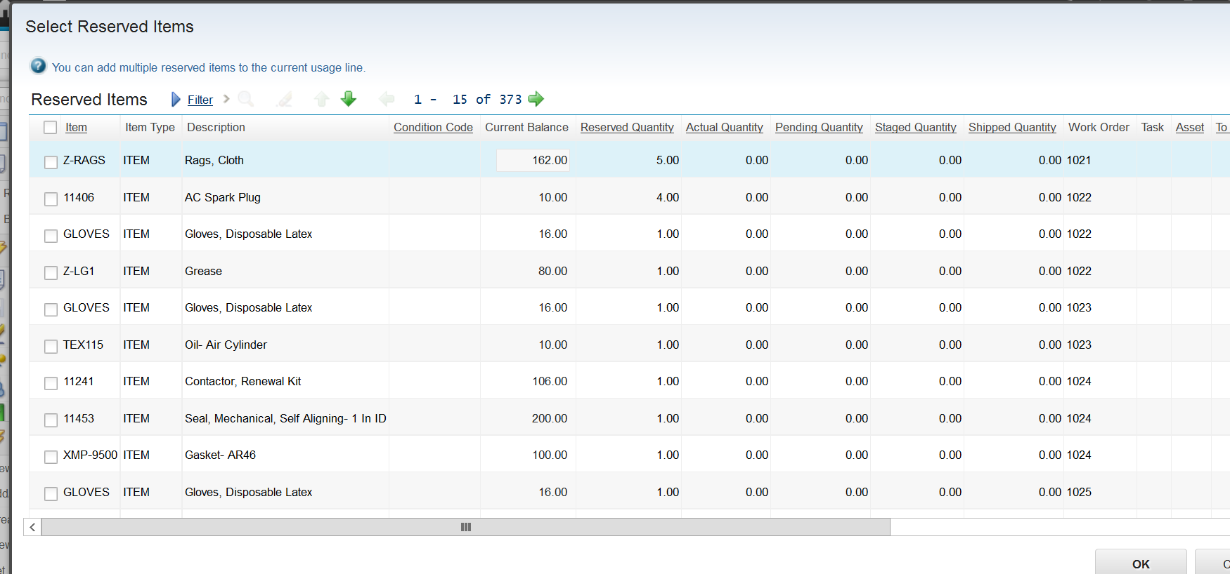

    I solved this in a different way.
    "Select Reserved ITEMS" in Inventory Usage APP works on INVRESERVE Object.
    INVRESERVE object has a relationship with INVENTORY objetct called "INVENTORY". This is very important because INVENTORY has a field called CURBALTOTAL and this is what I want to use to solve this
    Then, in the application editor, above INVUSAGE, I edit (in the dialog editor) "selectedreserveditems".
    Open the window where I add a new column and In the attribute field, I choose INVENTORY.CURBALTOTAL
    The result would be this one below

    Excellent! I had not looked for such a relationship since item and workorder were not relationships. This will meet the minimum requirement, I think, although sorting and filtering don't seem to be possible.
    Thank you.
