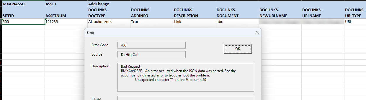

    When trying to update URL attachments to our assets, we get a cryptic error seen below. Is it possible to load DOCLINKS with MxLoader?

    This is what I use with MXITEM. Are you using secured attachments? Did you try in Debug Mode (under Cofig tab) and see what the log file says?
    MXITEM ITEM Sync-AddChange itemnum IN ('chair')
    ITEMNUM ITEMSETID DESCRIPTION STATUS DOCLINKS.ADDINFO DOCLINKS.URLTYPE DOCLINKS.DOCTYPE DOCLINKS.DESCRIPTION DOCLINKS.DOCUMENTDATA
    chair SET2 chair ACTIVE 1 FILE Images chair.jpg file://c:/chair.jpg

    Thank you for the idea to check the log. The problem was the True value in "AddInfo" column. In the JSON, it did not have quotes for some reason. I took out that column and it worked perfectly. Thanks!
