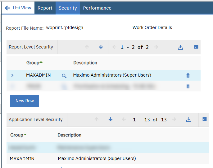

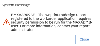

    When the script is run, it throws the following error. The security should be configured correctly (MAXADMIN user is in MAXADMIN group). We have SAML implemented and can't log in as the MAXADMIN user, so I can't tell if it would run manually.
    Jason Johnson
    RSI
  • 5.  RE: Publish channels and Reports
    Posted 08-27-2025 09:01
    The error message saying "workorder application" makes me think you used workorder instead of wotrack (or whatever the appropriate application is) in this section of the code.
    reportBytes = reportAdminService.runReport(MXServer.getMXServer().getSystemUserInfo(), "asset_detail.rptdesign", "asset",parameterData, fileName, ReportAdminServiceRemote.OUTPUT_FORMAT_PDF)
    It's confusing but the thing after the report is the application you are "running" the report in. In the case of asset, the object & app name match but in work order, it should be wotrack or one of the clones.
  • 6.  RE: Publish channels and Reports
    Posted 08-27-2025 11:28
    Thank you, your response led me to the error. I had the incorrect app name in the code (workorder instead of wotrack).

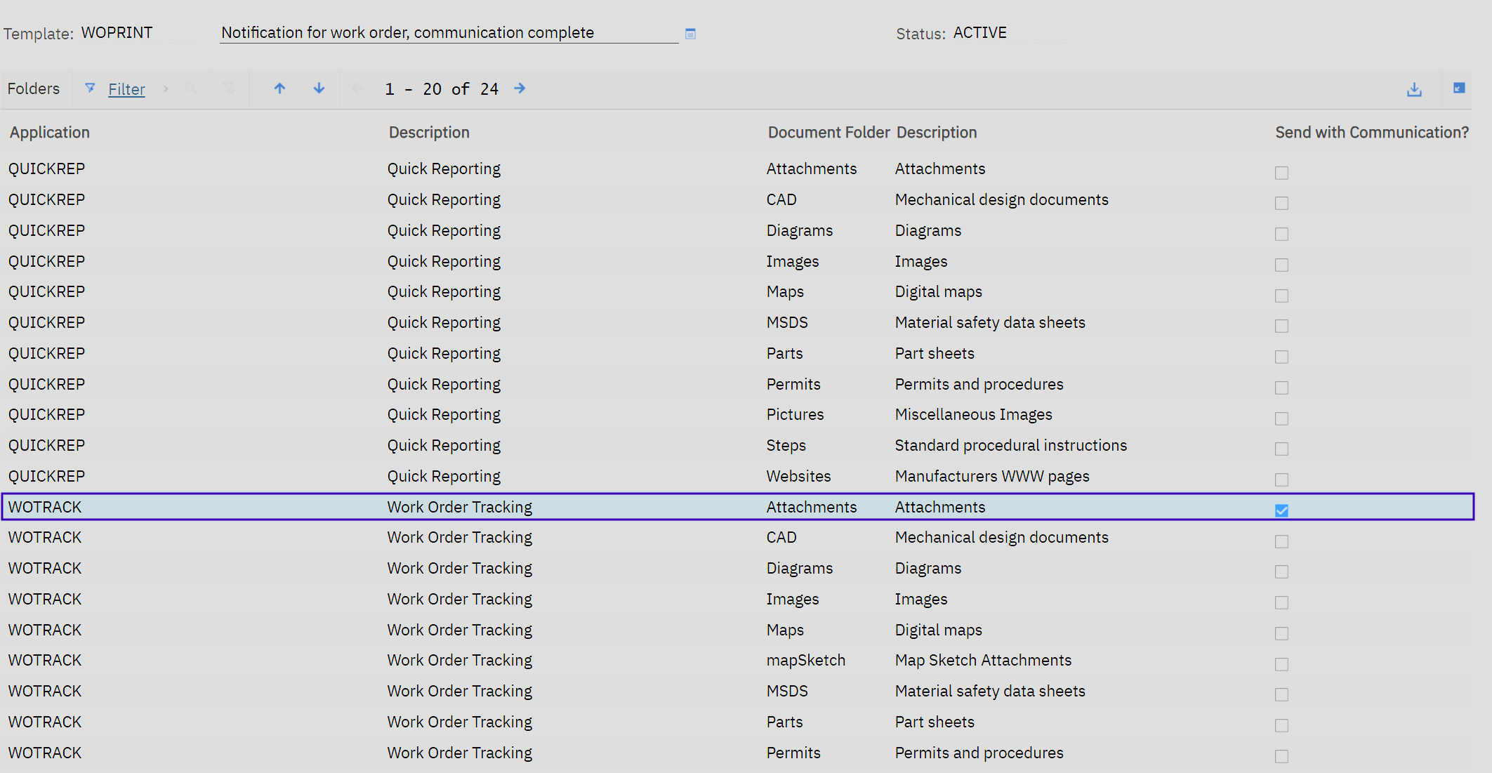

    I missed your post communicating your successful test; the only missing component is the attachment.
    What's missing from your script is the code snippet below:
    assetSet=service.getMboSet("ASSET",MXServer.getMXServer().getSystemUserInfo())
    assetSet.setWhere(whereclause)
    assetMbo=assetSet.getMbo(0)
    doclinkSet=assetMbo.getMboSet("DOCLINKS")
    docStore=AttachmentStorage.getInstance()
    doclinksMbo = doclinkSet.add()
    newFileName=docStore.getAttachmentQualifiedName(doclinksMbo,fileName)
    docStore.createAttachment(newFileName,reportBytes,"application/pdf")
    doclinksMbo.setValue("URLTYPE", "FILE")
    doclinksMbo.setValue("URLNAME", newFileName)
    doclinksMbo.setValue("NEWURLNAME", newFileName)
    doclinksMbo.setValue("DOCTYPE", "Attachments")
    doclinksMbo.setValue("ADDINFO", True)
    doclinksMbo.setValue("DESCRIPTION", "Test report", doclinksMbo.NOACCESSCHECK)
    doclinksMbo.setValue("PRINTTHRULINK", False,doclinksMbo.NOACCESSCHECK)
    assetSet.save()
    assetSet.cleanup()
    After modifying your script:
    1. Navigate to the Communication Template application
    2. Select the Communication Template > Attachment Folders Tab
    3. More than likely, the Attachment Document Folder exists
    4. Set the Send with Communication? flag to True (checked)
    5. Save
    6. Retest
    Theoretically, implementing these changes yields the expected behavior.
