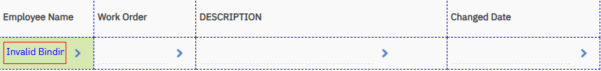

    I am in need of some help.  I have created a start center and in it an application that tracks work order completed by employees. What I am having a challenge with is that in the start center, when I click on Employee, Work Order, Description, changed date,  nothing shows up, I cannot see any data listed.  What am I doing wrong?

    I'm sorry to say, but that did not provide clear enough information, so I'll respond based on the feature seen in the image.
    Your image that you attached vs the mention of the start center doesn't align.  Why?  Because the dotted lines indicate that this is a screenshot from the Application Designer. As the other columns display correctly, it means you have something wrong with the binding (duh!), i.e., you have the attribute pointing to something that does not exist or has been misspelled.
    Q: Does that attribute exist on the object that the application is supported by?  For example, the Work Order Tracking application is supported by the WORKORDER object.  Therefore, there are attributes WONUM, DESCRIPTION, CHANGEDATE, but not EMPLOYEENAME.

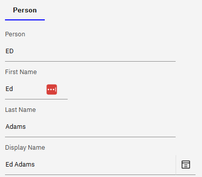

    ED is the assigned supervisor, but that is not his full name.  This is a code, it just happens in this case that when the person was set-up they used the actual person's name, but that is not the usual case, and instead it could be their employee ID or email address.
    ED's real name is stored in the People application, which is supported by the PERSON object, and the following is ED's information.

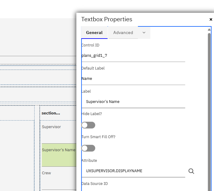

    To display the full name in your application, you have to:

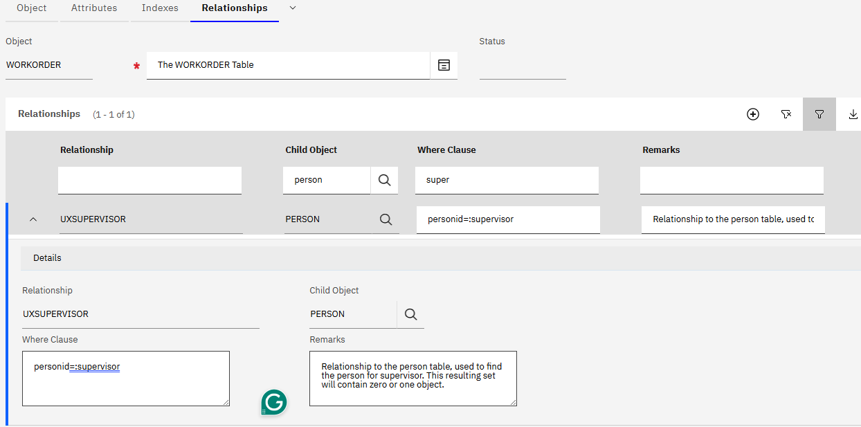

    1. Create a relationship between the WORKORDER and the PERSON object with a where clause PERSONID = :SUPERVISOR

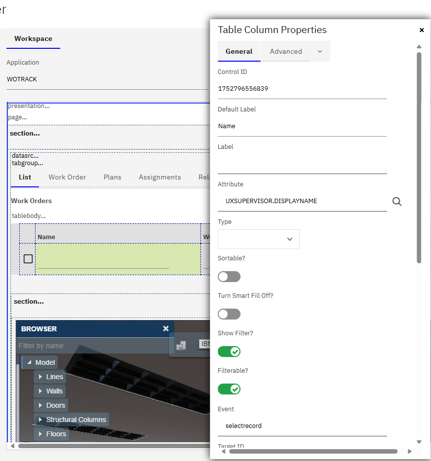

    2. Add the field to the UI or the list tab
    Adding it as a field
    Relationship

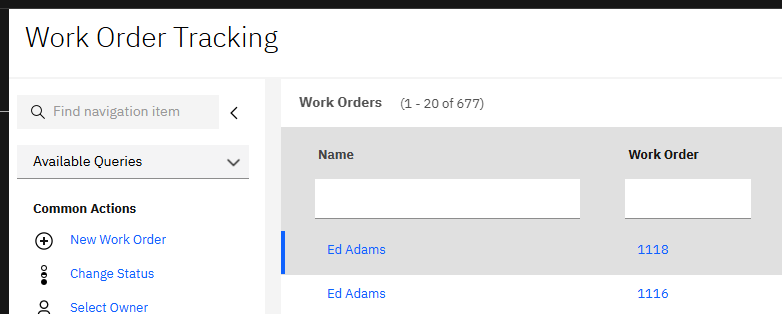

    Added as on the List tab
    Result for the List tab
