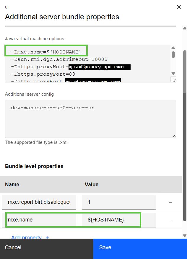

    Steve, I added -Dmxe.name=${HOSTNAME} to bundle jvm option per Mark Robbins suggestion.  Are you saying instead of jvm option, I need to add to Bundle level properties, an entry Name=mxe.name and Value='your server name'?  What would be correct value?  Ideally, we need pod name to be populated as we have multiple pods per server bundle. Would ${HOSTNAME} work in this place?

  • 10.  RE: Unique Server Name for each server bundle/pod to show on MAS manage users application in server sessions tab
    Posted 06-30-2025 15:39
    Jiang, I think you need both.
    Steven Hauptman
  • 11.  RE: Unique Server Name for each server bundle/pod to show on MAS manage users application in server sessions tab
    Posted 07-01-2025 09:24
    Thanks Steven,  set both jvm option and bundle properties as show in screenshot below still didn't work.  So far the best solution is the sql provided by Maycon Belfort.

  • 12.  RE: Unique Server Name for each server bundle/pod to show on MAS manage users application in server sessions tab
    Posted 07-01-2025 15:51
    Hi Jiang, in the bundle level properties give it a name like JIANGSERVER.
    Steven Hauptman
  • 13.  RE: Unique Server Name for each server bundle/pod to show on MAS manage users application in server sessions tab
    Posted 07-02-2025 08:52
    Hi Steven, in our production we have 12 UI pods, if I hardcode mxe.name = XYZSERVER, won't all maxsession user sessions have XYZSERVER serverhost value?  The goal is to have serverhost field display the specific UI server bundle pod name that a user session is running in.

  • 14.  RE: Unique Server Name for each server bundle/pod to show on MAS manage users application in server sessions tab
    Posted 07-28-2025 06:47
    Hi Jiang, Thanks and It's fixed. Able to see servername by setting property on Server Bundle additional server bundle properties with name as mxe.name and value as SERVERNAME (without quotes).
