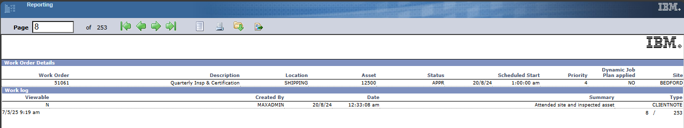

    Hi Crawford
    The only bit of your use case I don't quite understand is the "for a parent work order" and "both workorder and activity"
    Are you wanting to run the report from a task work order to get its parent's work log, or are you running the report from the work order with children and want their work logs, plus the parent's?
    This is a screenshot from an ad hoc report where I have added the work log object
    All you have to do, as suggested by Stevie, is enhance the REP_WORKORDER object, like I have to link the work log.  In this case, I will get the work log from the parent.
