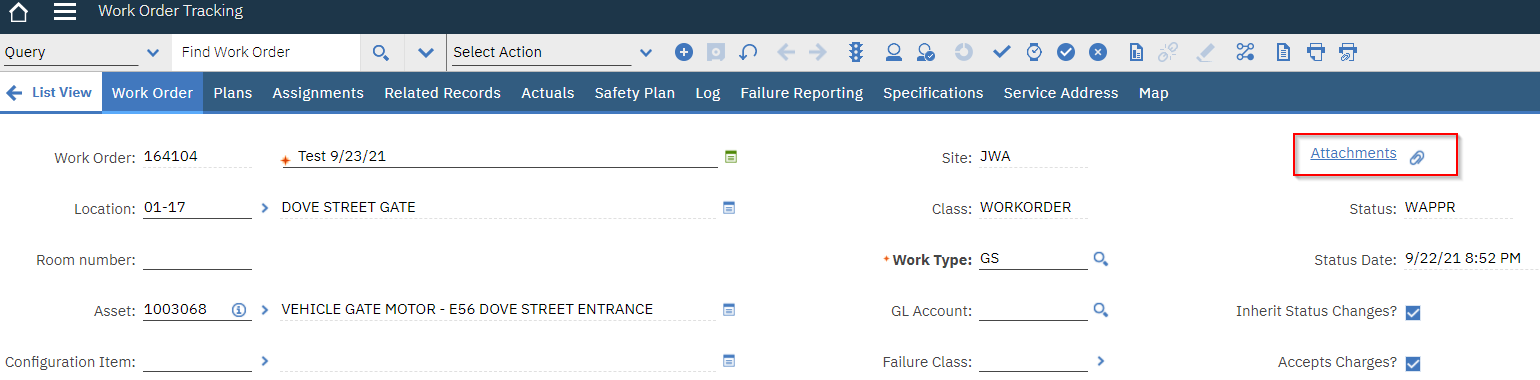

I can't tell you which option we used however our link to attachments is blue and underlined when attachments are present. It has been like this now for about 2 years with no issues we are aware of.

We wanted to show the fact that there was an Attachment so I set up a relationship between the main table (e.g. ASSET, WORKORDER) and DOCLINKS, but I added into the relationship statement "and rownum <=1" e.g. named DOCLINK1.  This means no matter how many attachments are there, only ONE is shown.  Then I added in the combo field below the attachment icon and displayed the "DOCLINK1.DOCUMENT" and "DOCLINK1.NAME".  This means if the fields are populated, you know there is at least one attachment.
