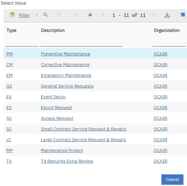

Minor how to question: How can I make 3 of these work types NOT show anymore when our Work Management team is assigning a Work Order Work Type?  The Organization stopped using the work types for future work orders (but has some COMPLETED work orders with the work type.)
I'm hoping to eliminate them as an option from the selector to prevent people from accidentally picking them out of habit.

Try adding a new lookup to the lookup XML with a where clause that limits the work type values. For example, if you don't want the users to be able to select EM, ES or T4, then put the following where clause in the new lookup:  whereclause =" worktype not in ('EM','ES','T4')".  The lookup can otherwise be identical to the out-of-the-box worktype lookup. You can use this new lookup on the worktype fields on the data entry tabs of your applications while leaving the original worktype lookup on the Lists and in the Advanced Search.  That way, users will only see the active work types when they are creating or updating work orders, but they will still be able to search for work orders using the older values.
