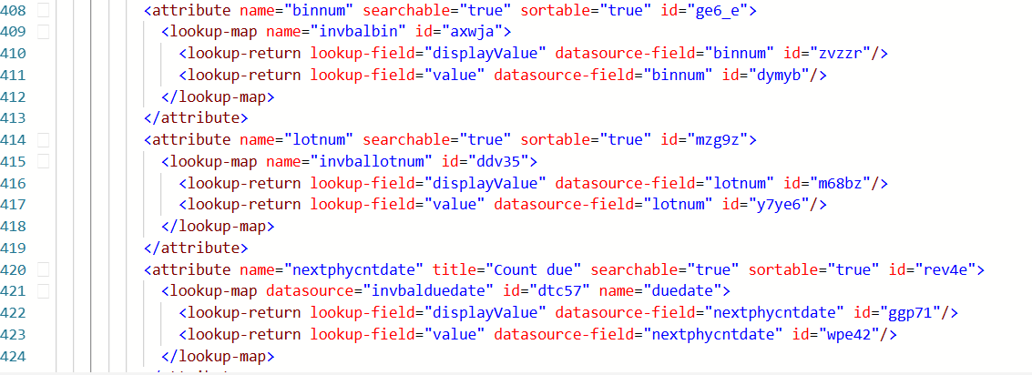

This is what I have constructed so far within the MAF:
(I have manually typed in lines 421->424)
However, when I publish these changes, it does not appear to have any effect on the filters screen. As shown below, only the "Bin" and "Lot" filters can be seen:
I was wondering:
1) Am I missing a step? Do I need to define the filter elsewhere, perhaps in one of the .json files? The page I first linked hints at doing so, but does not claim that it is necessary so long as the "datasource" attribute is defined inside the lookup-map tag.
2) Are the changes failing to take effect because I manually typed the lines? I ensured that I hit save, but perhaps you are meant to develop changes by utilizing the "properties" toolbar, or something similar?

When you define the lookup-map, you should use datasource or name, never both. name is a special reference to the JSON file you alluded to that defines what is in the lookup-map. When you want a datasource that you have defined in your application, you will NOT utilize a name.
invbalduedate is not a datasource I see in the out of the box app.xml. I bring this up because you need to make sure you define this type of lookup datasource with the same object structure and saved query as used in the other applications. You cannot have a saved query in TECHMOBILE that uses one query and another in ICMOBILE for example. That's not causing your current problem but it's another mistake I see people make often so I wanted to call it out.

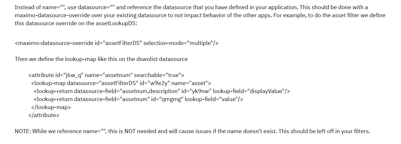

Based on the IBM thread, I thought it appropriate to add in a maximo-datasource-override as follows:
I left it very "barebones", as I'm not quite sure what options are appropriate here. It is my understanding, though, that this will allow us to reference this datasource within this application without affecting other applications that utilize this datasource. This is desirable behavior!

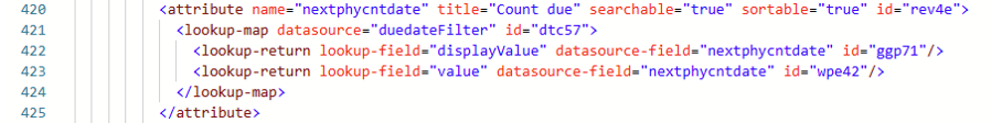

I also changed the lookup-map to *only* make reference to the datasource, as recommended. It now appears as follows:
I chose to have it reference the "duedateFilter" datasource, as that is what appears to have been done within the IBM article, as shown below:
However, despite these changes, my filter screen still appears to only show the "Bin" and "Lot" filters as options (same result as in the original post.)
