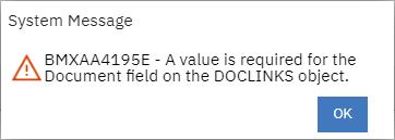

We have a simple little script to add a URL attachment to an asset. However, it results in an error that it requires the Document field. When we add that to the script, it errors again. Is there something we're missing?

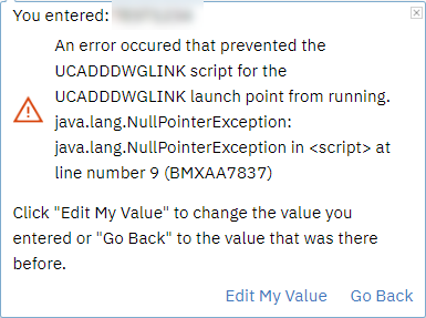

Error message with script as is
Error message adding line 9
doclinksMbo.setValue("DOCUMENT", "ABC")

Hi There,
You are getting null pointer exception because there might be some white space or something on line 9,can you check if there is some special character or white space on the field that you set  with name as "document",could have come up when you copy pasted from editor.
mark robbins's profile image
mark robbins
A null pointer exception occurs because the code is trying to call a method on an object that hasn't been set.
So using your code we can tell :
Doclinksmbo is the object that hasn't been set.
Setvalue is the method
So the question is why hasn't the Doclinksmbo been set?
The object will be set when the code to get the doclinks mboset gets an mboset and when the add operation works
So it looks like one of those has failed
You should check the systemerr log file for errors eg unable to ADD record or missing relationship
If you want to add code to handle this situation then add code like this:
If doclinksMbo is not None:
#Your code here
Else:
#Log a warning about null mbo
Jason VenHuizen's profile image
Jason VenHuizen
Jason,
Here is an example of a script that will create a new document with a URL link to our website on save of an asset.  If the document with URL already exists it just reuses that DOCINFO record and adds the doc link.
I have included the scriptConfig variable so you can use our Maximo development extension for VS Code to deploy it directly to Maximo for testing. https://marketplace.visualstudio.com/items?itemName=sharptree.maximo-script-deploy
