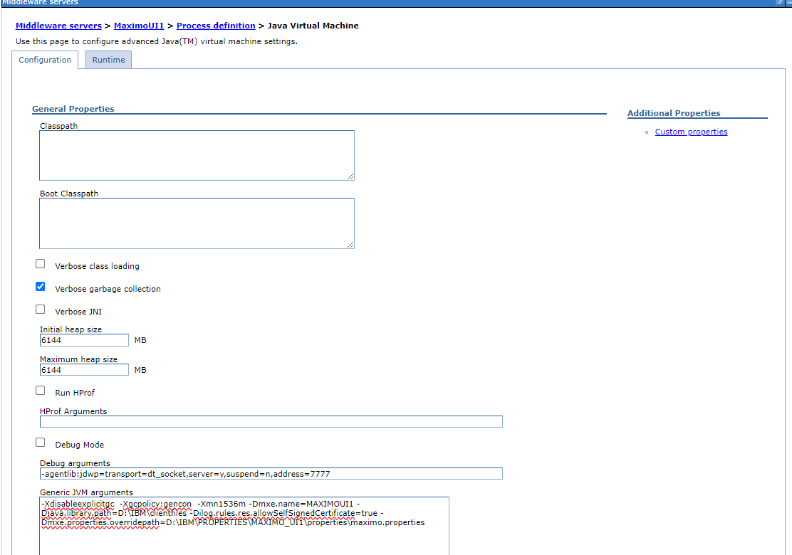

Michael Krawietz's profile image
Michael Krawietz
Stepping into this late in the game but wanted to add one additional thing to the conversation.
For ease of changing Maximo properties such as connecting to alternative database servers during testing I strongly suggest using a properties override in the Process definition Java Virtual Machine Generic JVM arguments
i.e. -Dmxe.properties.overridepath=D:\IBM\PROPERTIES\MAXIMO_UI1\properties\maximo.properties below. This allows a quick change to the file and a simple restart inside WebSphere.
