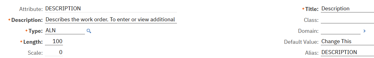

If you have a true static default (IE it's not based on something from another record), the database configuration default value is the proper approach. For example, if you wanted the description to be "Change This"
