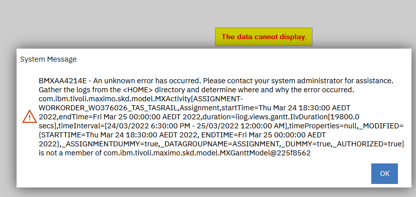

Issue with receiving ..."is not a member of com.ibm.tivoli.maximo.skd.model.MXGanttModel@225f8562" when selecting the Work View or Assignment View in GA
  • 1.  Issue with receiving ..."is not a member of com.ibm.tivoli.maximo.skd.model.MXGanttModel@225f8562" when selecting the Work View or Assignment View in GA
    Maximo Certified
    Posted 15 days ago
    I have been experiencing the error when a user simply selects either the Work View or Assignment view in GA.  The simple solution is to select the "Refresh Work List", but I should have to do that if I don't want to refresh.  NB: The "Refresh When Opening the Gantt View?" is not selected.
    So, if I look at the work order, it's there, but if I then duplicate or create a snapshot or scenario, it works for those, but not the original.  This is most likely because there is an element of refreshing occurring.
    My detective work has indicated that there are work orders that has been closed or cancelled since last looking at the schedule.
    But, I believe there is some routine run everytime you switch to the tab, but IBM cannot tell me what that is, nor can I capture is in the SQL log.
    Has anyone else experienced this, and it yes, what if, any, solution other then using the Refresh button have you found.
