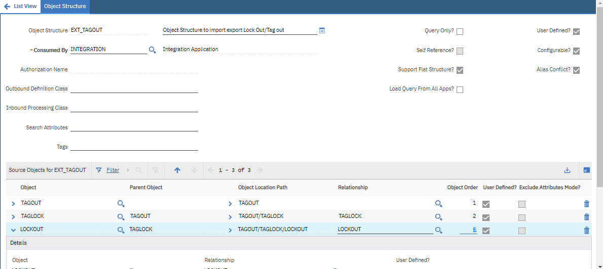

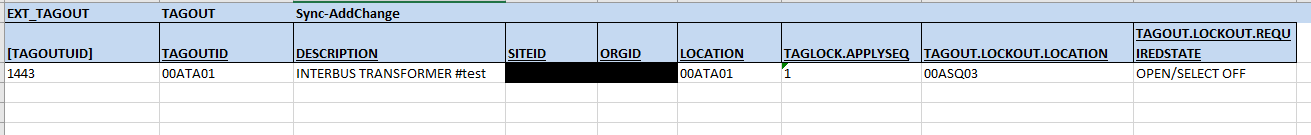

    I am trying to upload Tagout/Lockout  records via mxloader.
    whenever i upload Data in system everytime if i re-run the mxloader sheet it will create new record in lockout operations
    My object structure look like this.

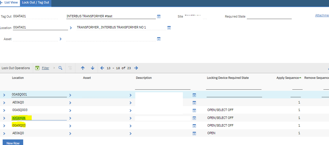

    Data get duplicate as highlighted whenever i try to update the existing data
    Kindly help me how to update existing record  in Lock out operations. Not to create new record everytime.
