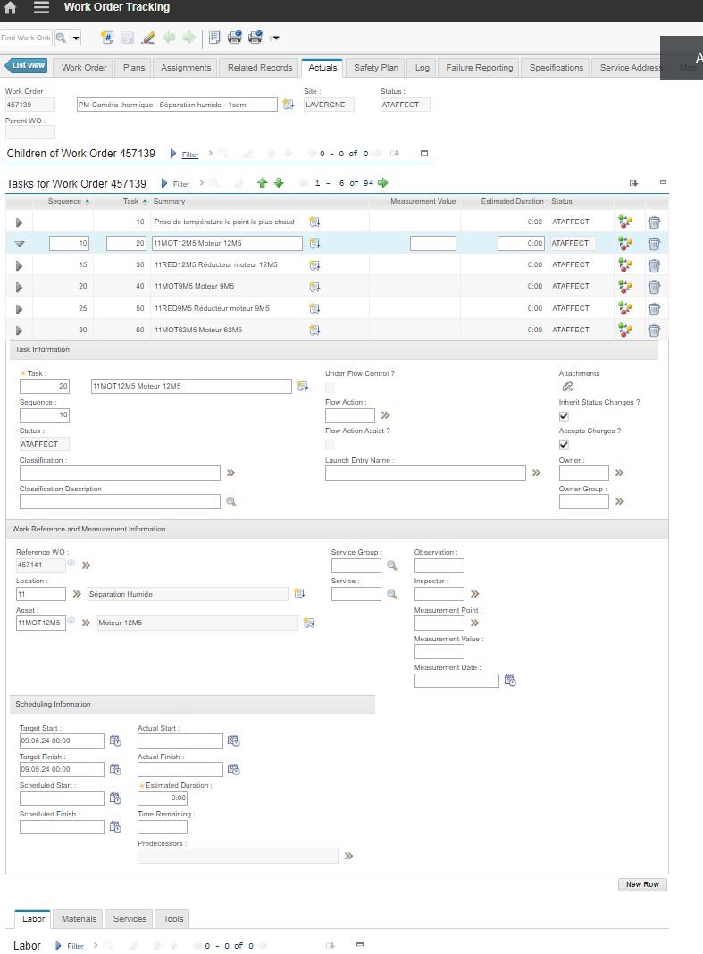

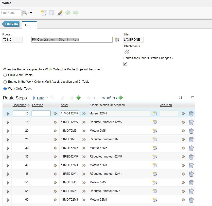

    Hi Martin,
    let me explain the situation.
    I created a route to take the motor temperature (hot spot) with a thermal camera. I created a meter (TEMP) and also a MEASURE POINT to trigger a job plan if the temperature measure is above overheat setting. So the in WO created by the PM with the route and job plan to take those temperatures, I cannot see the measure point of each asset and also those measures reading are not record in the database.
    I let some print screen to show you.
    steve lizotte
