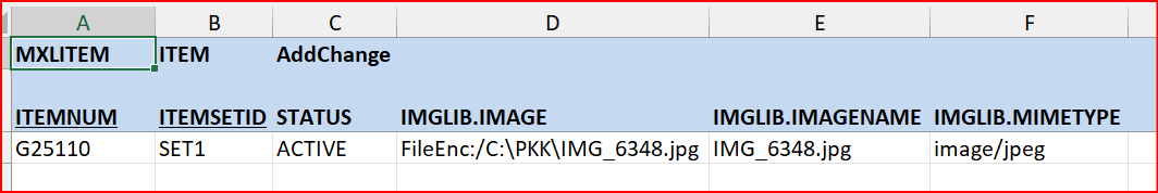

    I was able to upload without the script. This is what I did
    1. Create a new OS by duplicating the OOB MXITEM OS
    2. Keep only ITEM and IMGLIB as the objects in the OS
    3. Under the More Actions select the Configure Object Structure security
    4. Check the "Use Object Structure for Authorization Name"
    5. Go to the Security Group of the user which will be used to upload the images and under the Object Structure tab provide access to the above newly created OS
    6. In the MxLoader Config tab, I used the service as OS and Authentication as API
    7. Used the below in the MXLoader Sheet
    8. image
    9. I was able to upload the image by following the above steps
    Priyaranjandas Kolambkar
    COSOL Global
