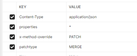

maxauth: c21pdGg6c21pdGgx
Content-Type: application/json
properties: *
x-method-override: PATCH
patchtype: MERGE
The maxauth header represents the credentials that are being used to broker the transaction. The value is a base64 encoded string of the format USERNAME + ":" PASSWORD. In an LDAP environment, switch the maxauth header to Authorization and prefix the string "Basic " to the base64 encoded value. The Content-Type header tells the HTTP request that the body of the message will be in JSON format. The properties header tells the request which fields from the MXASSET Object Structure should be sent back in the HTTP response, with the * character representing all fields in the object structure. The x-method-override header with a value of PATCH tells Maximo that this will be an update to the asset record, and the patchtype header with a value of MERGE tells Maximo to add a new record while keeping the other ASSETMETER records. Without that header, the integration will replace all of the ASSETMETER records with the list in the message.
