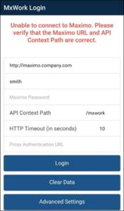

    URL:  If it's your Maximo URL that is causing the issue, then it could be something as simple as a misspelling or an extra symbol being entered by mistake so check for that.  Another thing to look for is if you're using "http://" instead of "https://" or vice versa.  If you didn't enter one of the two protocols, then the app will automatically add "http://" to the beginning of your Maximo URL.  So, if that is incorrect then replace it with "https://" and try logging in again.

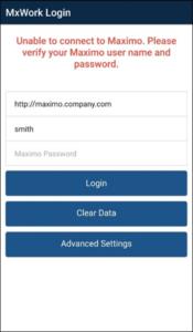

    User Name & Password:  Once again, it's quite possible that your Maximo URL is misspelled or an extra character/symbol is being entered somewhere, so check for that and try again.
    API Context Path:  By default, A3J's Maximo specific apps use "/maxrest" as the API context path, but your Maximo environment may require a different path.  I've seen that "/maximo" works for our internal environment so that may be another option to try on your end.
    Timeout Length:  If you made it to this point and all of your information above is correct, then your mobile device may just need more time to log into the app.  Simply click the "Advanced Settings" button on the login screen and increase the number of seconds from "10" to "20" or more and try logging in.
