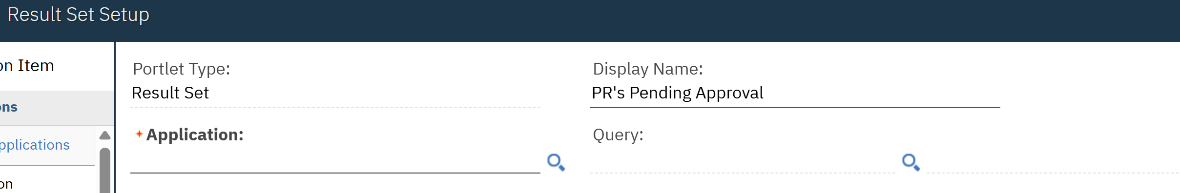

    Posted 10-06-2025 20:06
    Hello @Steven Shull, I am wanting to test adding PR to this application choice.  Do I need to do the above for that?
  • 8.  RE: Start Center Result Set
    Posted 10-06-2025 20:17
    You would see PR as a valid application whether or not you had object structures configured in the application. If you did not have access to a report object structure for PR, then you would only be able to select details from the main PR object (wouldn't be allowed to select things like the PRLINE).
    If you don't see the PR application, make sure you have security access to the PR application and a saved query that you can see. That means either a saved query that is public or a saved query that you made if it's private. Since a query is required (we don't want to fetch entire tables), IBM makes sure that you can pick a query before letting you select the application.
